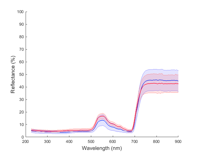

Hi Stephen Tashi,
My data were spectrophotometer traces of leaves of a given plant species. I want to know if two different species can be distinguished from each other based on their reflectance. But most green plants have a very similar spectrum, for instance, for two different species I found:
Do you think PCA can be useful in pinpointing key differences in a given species that will help identify it from another species?
Stephen Tashi said:
An arithmetic sum of variables is very special way to model a combined effect. If there is a physical situation where "adding" things to a system involves all sorts of interactions among the things, then it will be surprising (but not impossible) if the combined effect of some property of the system is the arithmetic sum of certain properties of the things added.
In this case, what is considered the "variables"? Is it the chemical constituents, or the wavelengths over which the measurements were taken? As I understand it, the original variables are supposed to be interrelated. PCA transforms into a new set of variables, the principal components, which are then uncorrelated.
Also, the spectrum of a leaf is mainly a linear superposition of the spectrum of chlorophyll, water, and dry matter.
I don't know. To investigate this graphically, you need to look a graphs of the coefficents of the principal components and NOT graphs of the principal component functions themselves. The same functions (principal components) are used in making the description of each species, so graphing those functions doesn't tell you anything about how well the descriptions can distinguish species.
If you graph the coefficents of the principal components of a species, the x-axis won't be 200 nm, 300 nm, ... etc. The x-axis will just be 1st, 2nd, 3rd,...etc. It's best to think about the coefficents of a given species as a point in k-dimensional space where k is the number of coefficients we will use in classifying species. The geometric question is whether these points are easily separated from each other by some algorithm or whether they are all bunched up together.
Your PCA treats each wavelength as a separate variable. It doesn't explicitly model any function that relates the variables.
For example, suppose we have a 20-item rating system for people. The items are things like : sense-of-humor, religious fervor, honesty, shyness,..etc. Applying PCA to these measurements doesn't explicitly model any function that relates (for example) the rating for honesty to the rating for religious fervor. PCA does, in a manner of speaking, account for any linear relation between those two qualities that emerges just from statistics of the population.
For example, there is nothing in the PCA that enforces the idea: Reflectance is a smooth function of wavelength, so the reflectance of a given sample at 350 nm will be close to its reflectance at 300 nm.
Most ideas of "correlation" have to do with a probability model. I think your statement is correct if the probability model is "pick a leaf that was tested at random from the population of those tested".

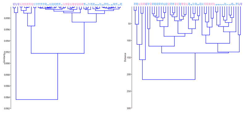

Hi Stephen Tashi,
I managed to plot the observations for two species with respect to their first two PCs. For one species I had 25 measurements (shown in blue), and for the other species I had 10 specimen measurements (red). Assuming that my computations were correct, here is what I got:
Close-up:
If I draw a convex hull around each species, the red species will be completely encompassed by the blue. Does this mean that we cannot differentiate the two species from each other?
When I tried to plot PC3 against PC1, the results were the same. In fact, according to Matlab, PC1, PC2, and PC3, respectively account for 99.8%, 0.0829%, and 0.0255% of the variation. I am not sure how to interpret that. But the percentage of total variation is a measure of how good the 2D representation is, so I think a higher dimension plot would not be very helpful.
Also, why do I get an extreme outlier for each set (as shown in the first picture above)? My spectrophotometric traces were all fairly close to each other — for instance, for the blue species I had:
Stephen Tashi said:
roam said:
The exception is the curve for the first PC; it resembles a complete reflectance measurement of a given leaf.
That might be remarkable , depending on how you applied PCA to the data.

Yes, that's very strange. But I am sure what I plotted is meant to be PC1 not the mean ##m(\lambda)## . I plotted the columns of the loading matrix for each of the PCs, so the first column corresponds to the first PC, etc.
However, I conducted the PCA on the covariance matrix, rather than on the correlation matrix of the variables (the software allows both methods).
Also in my data, the standard deviation varied a lot among the variables (e.g. being very small in the blue, and very large in the green region of the spectrum). Jolliffe's textbook says that in such situations you have to apply PCA on the correlation matrix:
"...using a covariance matrix to find PCs when the variables have widely differing variances; the first few PCs will usually contain little information apart from the relative sizes of variances, information which is available without a PCA."
Now when I applied PCA to the correlation matrix instead, PC1 no longer resembles a typical reflectance curve. Here is a comparison (covariance matrix on the left, and correlation matrix on the right):
So, how exactly does using the covariance matrix influence PC1 to resemble a typical reflectance measurement? :confused:

Hi @FactChecker,
My spectrophotometric measurements are based on 1350 wavelengths/variables. The aim of my project is to differentiate plants based on a much smaller subset of wavelengths. At the present, I want to know what the most significant variables are. When plotting the results of a PCA, if the separation between two known groups is in terms of a given PC, then plotting the loadings of that PC against variables (as in post #23) tells you what variables are most significant when it comes to distinguishing. The variables for which the loadings are largest in absolute value are the variables where the most important distinguishing features occur (at least that is my understanding). Do you believe I am on the right track?
As I understand it, cluster analysis doesn't really give this information. For instance, the following are the dendrograms I made based on Pearson's correlation on the left and Euclidean distance on the right (by the way, do you know why is the former such a better distance metric for classifying the spectra?). The colours indicate the actual group membership of a measurement.
Do you think regression analysis does a better job of telling you what the best variables are?

IMHO, yes. Stepwise regression analysis (see https://en.wikipedia.org/wiki/Stepwise_regression) is specifically designed to determine the best variables to distinguish between values of a dependent variable. So yes, it is made exactly for that. Your dependent variable can be a 0,1 variable which indicates the plant type. A forward stepwise regression would start with the single variable (wavelength) that does the most to determine the plant type. Then, having accounted for the first variable, it would look for the second variable which does the most to add accuracy to the determination. It continues like that till there are no other variables which are statistically worth adding. IMHO, the best version is "bidirectional elimination". After several variables have been added to the model, the early variables may not add much that a combination of the later variables do not already do. If the early variable is no longer statistically significant, the bidirectional elimination algorithm will remove it.
I have assumed that you are looking for the variables that distinguish between two plant types, not more. That allows you to define a 0,1 variable indicating the plant type. If there are more than two plant types which you want to analyze in the same model, that is different and my recommendation would have to be re-evaluated.
