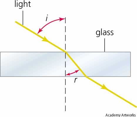

My question is this. We know that there exist certain refractive indices for light as it passes through various media. Say we have a rectangular prism. Light is hitting one of the long edges at an angle. According to my understanding of Fermat's PoLT as stated above, the light should travel through the prism forming a right angle at the entry point and a right angle at the exit point (on the inside of the prism). This would minimize the amount of time that the light is in the slow medium, the glass. The total travel time for light would also be minimized, I think.
Of course, this doesn't happen in real life. So my understanding of Fermat's PoLT must be lacking. Could someone explain where I'm going wrong with light and the principle of least time?
Something like this happens in real life:

Applying that principle requires being given two points that the light "wants" to go through.

A perpendicular crossing does minimize the time spent in the glass, but it extends the path through air of that emergent ray.

The time in the slower medium would indeed be minimized, but not the total time.
Do you know how to minimize a function of two variables?
