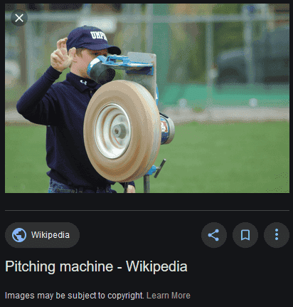

Hi all -
I'm not an engineer or even very good at physics, but I was hoping to learn about something I'm interested in. I bought a ball pitching machine that I've outgrown and I'm wondering about either modifying it or even building my own and wanted to know about some of the key principles behind it's physics.
In short, a ball rolls down a tube that is slightly intersected with a large spinning wheel, which has a speed control. The ball brushes this wheel and is projected out. The wheel itself is quite large (30cm), and makes for a relatively immobile machine. I was wondering whether I could reduce the size of this wheel and was wondering how this would affect the performance. (Also other factors i imagine might be the wheel's speed and even perhaps width). So are there principles out there that anyone knows of that I can be pointed in the direction of?
I'm sorry that is probably so poorly explained!
Many thanks!
Welcome to the PF. :smile:
Can you post some pictures? I'm more familiar with pitching machines that have two spinning wheels, but it does look like there are some single wheel pitching machines...

@dilby think about what you have to do with a smaller wheel to achieve the same exit speed as with a larger wheel, how long the ball will be in contact with the wheel in each case, and what will be the difference in the dynamics of the ball between the two.
If all you want is a general understanding so that you can play "what if", then the ESP method works very well. ESP, in this case, stands for Exaggeration of System Parameters. Make three sketches:
Sketch 1 is a simplified sketch of your machine - a 7 cm diameter ball, a 30 cm wheel, and the backplate that supports the ball.
Sketch 2 is a similar sketch, except make the wheel about 3 cm, or better, 1 cm diameter. Visualize how the ball approaches the wheel, and is pushed through the machine. Notice the similarities and differences from Sketch 1.
Sketch 3 is a similar sketch, except make the wheel about 300 cm diameter. You only need to show a small portion of the wheel. Visualize how the ball approaches the wheel, and is pushed through the machine. Notice the similarities and differences from Sketches 1 and 2. Also study Post #11.
Think about what happens when the ball first touches the wheel, what happens when the wheel makes firm contact with the ball, and the effect of small changes in ball diameter. Think about the performance, the size of the machine, and the relative cost of the machine.
