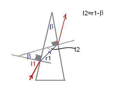

incident angle : 60 degree
apex angle : 30 degree
prism refraction index : 1,6
deviation angle : ?
You mean the angle of the prism? Why do you think it makes a problem if the angle of incidence is greater than that? What is the question?
ehild
if i solve this equation to find first refraction angle (r1) :
sin(I1) = np sin (r1), which (I1) is incident angle =60 degree, and np is prism refraction index = 1,6
i find r1 = 32,76 degree.
if beta = r1 + I2 , which beta is apex angle = 30 degree, and I2 is second incident angle,
i find I2 = -2,76 degree
i can't quite understand what's the meaning of (-) in my answer :/

It means that the second angle of incidence falls to the opposite side of the normal. See picture. You still can use ## |I_2|=|\beta-r_1|##. The second refracted ray will travel upward, in the direction of the apex.
I suggest to draw the rays always before applying a formula.

so i can still use
Deviation angle = i1+r2-beta to find second refraction angle? (r2)
thank you so much that enlightens me so much about prism.
many thanks man
You find r2 by applying Snell's Law for I2. And I1 and r2 and beta determine the deviation angle.
