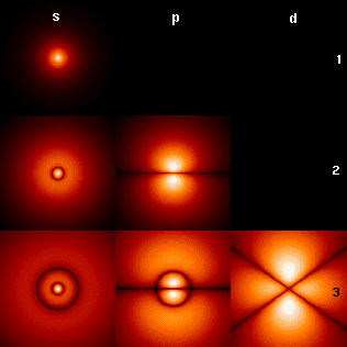

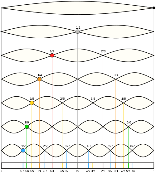

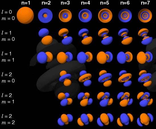

It's tough to answer those questions in a satisfactory way without getting into the math, which is often where the layperson gets lost. You may already be familiar with some of the following points, but bear with me, and I hope it will be clearer to you in the end how it all works.
Basically, quantum mechanics tells us that the electrons around an atom are distributed as waves in 3-D space .. we call these "wavefunctions". Furthermore, QM tells us that they are standing waves, analogous to harmonics of a violin string:
but in 3-D. As you can see, this means that the places in space where they have zero amplitude (called "nodes" stay fixed, as do the places where the amplitude is largest, although the latter points change phase (i.e. oscillate up and down) with time. Notice in the image that each harmonic has one more node than the next, and that each harmonic goes to zero at the end of the string. This is also true of the electron wavefunctions around atoms .. only certain solutions with nodes in well-defined places are allowed, and each wavefunction has a characteristic energy associated with it, which increases with the number of nodes (the lowest energy state, or "ground state", doesn't have any nodes, although it still has a non-zero energy). We call this "quantization of energy states", since only certain values of energy are allowed.
One of the fundamental postulates of QM is called the "Born interpretation". What that tells us is that if we take the square of the wavefunction representing one of the electronic energy states, then that tells us about the probability of finding an electron at a given position around the atom. Now, remember that the amplitude of the wavefunction at a node is guaranteed to be zero .. so that means that the probability of finding the electron at the position corresponding to a node is also zero. On the other hand, the probability of finding the electron at the peak or valley of a wave is rather high.
So, when you see images like the ones you are describing, the more intense bands represent the peaks of the electronic wavefunction (really the square of the wavefunction), while the regions with lower probability are concentrated around nodes of the wavefunction.
Now, you may now want to know *why* the quantum solutions to the electronic structure of atoms are waves in the first place. For that I suggest that you read the wikipedia pages on the de Broglie wavelength and the Heisenberg Uncertainty Principle to start, and then come back and ask more questions as they arise.
[NOTE: One technicality point I neglected in the above description is that fact that the solutions I describe are really for one-electron atoms only ... that is because electrons are charged particles that repel each other, which makes the solutions of multi-electron atoms much more complicated. However, most of the time the sorts of pictures you describe are for the H-atom solutions, like these:
In any case, the explanation I gave forms the basis for understanding electronic distribution around all atoms.
Thank you very much for the diagrams. I think I understand the principles of harmonics depicted above. My new question, however, would be: What is waving? Is it the probability of an electron at the various locations along the "string" which is waving?

In case you want an elaboration, it may also help to look at http://wiki.chemprime.chemeddl.org/index.php/Tones_on_a_Drum_and_Orbital_Wavefunctions" - that's basically the 2-dimensional version of the 1-dimensional standing waves on a string, so it's the intermediate between that and the 3-dimensional spherical harmonics which give the electron orbitals their overall shape.
Yes; the amplitude of the wave function is the probability that the electron is at that location.

So, the wave is in a spheres around the nucleus, and in the places where the radius allows for constructive interference/phase matching as the wave makes its way around will be where the electron orbitals are found?
No; there's no phase-matching or such. That's the de Broglie rationalization for the Bohr model of the atom, you have circular or elliptical 'orbits' around the atom which correspond to integer multiples of a wavelength. The Bohr model is wrong though. Electrons don't follow any specific path around the atom - things in QM don't move in nice trajectories, that would imply a well-defined position. They don't even necessarily move 'around' the atom - l signifies angular momentum, so the states where l=0 are states where the electron has no momentum perpendicular to the electron-nucleus line. In other words, to the extent that it can be described in moving in the classical sense, the motion is entirely in the inwards-outwards directions.
And the radii which cause destructive interference in the wavefunction would be areas where there is no orbital?
The orbitals are the solutions to the Schrödinger equation, and they're akin to standing waves in three dimensions. (so, 'wave-like' behavior). But the nodes (areas where the wave function/electron probability is zero) are part of the orbital; the whole orbital is 'where' the electron is. It's not a time average or any such thing, but the actual 'position' of the electron, as far as it's meaningful to talk about it.
