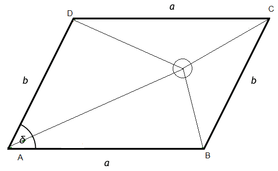

Maybe my bad English made the problem a bit confusing, hope this makes it clear.
In this draw scenario only two of the angles that the camera sees are acute.

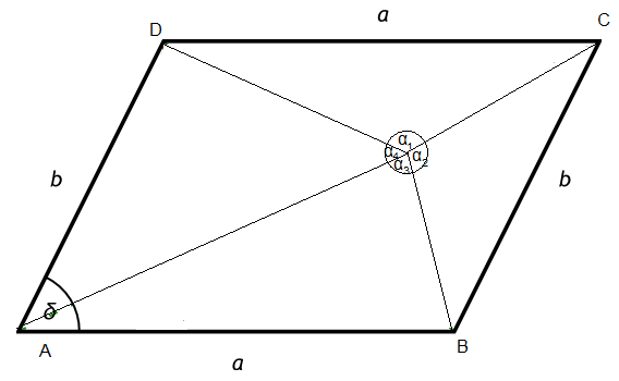

I updated the figure. ##\alpha_i## are the angles I'm talking about. Trivially ##\sum{\alpha_i} = 360^\circ##, but some of them are acute, some of them are obtuse angles depending on 1) where the point is inside the parallelogram, 2) what the parameters of the parallalogram are ##(a, b, \delta)##.
The first part of the problem is to find the set of points inside the parallelogram where at least 3 ##\alpha_i## are acute or right angles (where ##\alpha_i \leq 90^\circ##). The only case when there are four such ##\alpha_i## is when ##a=b##.
The second part is just simply about calculating the probability of finding such a point if we randomly choose a point from inside the parallelogram.
Forget all the camera, 2d room stuff, my teacher has some weirdly phrased exercises, but this is the mathematical problem I'm dealing with.
