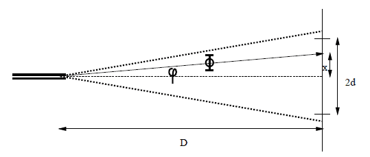

A rifle shooter aims at a target at a distance D, but has an accuracy probability density
ρ(φ)=1/(2Φ) φ∈(-Φ,Φ)
where φ is the angle achieved and is bounded by the small angle ΦPart A
find the probability density for where the bullet strikes the target , ρ(x) . The target has a width of 2d . H denotes the event where the bullet hits the target whereas M denotes that when it misses. Calculate and depict the probability of hitting
P(H;Φ) as a function of Φ for fixed d and D with d=Dtanθ

What, exactly, is meant by "setting the sights" in part B? Although your writeup does not at all made this issue clear, it looks like the effect of choosing ##\psi## is, perhaps, to made the shooting angle come out uniform over the interval ##(-\Phi + \psi, \Phi + \psi)##. Is that the case? Also, it sounds as though the shooter sets the sights deliberately and manually, so that ##\psi## is some fixed number. It then seems strange to have it be random, as in part D; but I guess an exercise in probability does not have to make practical sense, just mathematical sense.
After these issues are clarified I will be better able to offer comments.

Don't forget that for ##\psi \neq 0## the shooter is aiming off center, so the plane containing the target is at a slant. That makes the overlap probabilities a bit trickier to find (although the number of cases is not changed).

Don't forget that when ##\psi \neq 0## the shooter's "aiming cone" is off-center, so the target's plane is at an angle to the aiming cone's center. That complicates the computation of overlap probabilities a bit, but the number of cases is still the same.
How does that make it harder? It's just a shift in the range of angles, no?
Well, yes, but the x-locations of the target ends must be translated into angles, and that involves a small bit of trigonometry. After that, it is the same as before.
What x locations? We're given d=Dtanθ, so we can work entirely with θ, Ψ, Φ.
OK, I missed that.

α is smaller than the sum of max x and max y in the rectangular region, which is exactly the case for the angles.
α=ψ+φ and the max values of x and y are really just phi and psi, which is why i don't see any other intersections. an analogous case would be setting x+y = 3 in your example. and would you mind explaining why this method would help me in figuring out the limits?
In the above example, assume the units of measure are such that [-2,2] and [-1,1] make sense for measurements of angles. Thnking in terms of discrete random variables, to compute the probability that x + y = 2.5 we have to add up the product [itex] p_\varphi(x) p_\psi(2.5-x) [/itex] for all values of x where this is possible. The only values for which it is possible are those on the line segment of x + y = 2.5 that is within the rectangle. On that line segment x ranges from 1.5 to 2. So the summation would use those limits on x. By analogy, in the continuous case, the integral is [itex] p_{\varphi + \psi}(2.5) = \int_{1.5}^2 p_\varphi(x) p_\psi(2.5-x) dx [/itex].
I see. I suppose it also explains why it doesn't matter with which variable I integrate the expression to get my convolution. However, when I apply it to the angles, I will always get a line intersecting the rectangle only at one corner as long as ψ and φ are positive and α=ψ+φ. Does it mean that the convolution is simply zero ?
Are you using [itex] \psi [/itex] and [itex] \varphi [/itex] to represent the numerical end points of the intervals or to represent random variables? In the above example the line segment [itex] x + y = 3 [/itex] implies an x-interval of length zero, so the integral over that interval is zero.
They should be random variables. The endpoints are ±Ψ and ±Φ.
Yes, in the example [itex] p_{\psi + \vartheta} (-1 -2 ) = 0 [/itex] and [itex] p_{\psi + \vartheta}(1 + 2 ) = 0 [/itex].
  • #31
For part C, I suggest the easiest way to get the overall density function is to define ##A = \frac{\min\{\Phi, \Psi\}}{\Theta}## and ##B = \frac{\max\{\Phi, \Psi\}}{\Theta}##. Then consider three ranges: A+B < 1, B-A < 1 < B+A, B-A > 1. You should get a fairly simple graph.
I don't see this as a step towards part D, though. For part D, you have a sequence of scores Xi out of N. You could try an MLE approach, but it gets horrendous. You'd need a separate ##\psi_i## parameter for each Xi, and maximise likelihoods based on each shot having success probability ##\Theta p_i = \min\{\Theta, \psi_i+\phi\} - \max\{-\Theta, \psi_i-\phi\}##; even then that's only if ##\psi_i-\phi < \Theta## and ##\phi-\psi_i > - \Theta##; outside that range it's zero. And the likelihood of Xi is a binomial function of pi.
So I suggest putting all the algebra to one side and approaching D in a more commonsense manner. If ##\Psi## is large and ##\Phi## is small, what would you expect the distribution of Xi to look like? What about small ##\Psi## and large ##\Phi## ?
