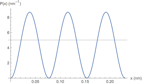

For how many values of x does P(x) = 5 nm-1?
ANS: 6 values of x
3)What is the largest value of x for which P(x) = 5 nm-1?
ANS: ?

For question 2 i only know its 6 because the question was multiple attempts. i don't know how to get that answer mathematically. I thought that by integrating P(x) squared and then solving for the x's would give me the 6 values of x but its not making sense to me. After i have the 6 values, then the answer to question 3 is just the largest value of x.

Plot P(x) as a function of x from 0 to L and you will see.

I solved this and couldn't get 6. i tried with my calculator in radians and degrees.
Here is the plot of P(x) vs. x. Note that the 5 nm-1 line crosses the plot at 6 points.
Likes gv3
Ah ok. I was graphing the wrong thing. Thanks for helping me! Sorry for the confusion.
