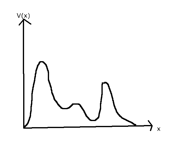

The potential is like this:

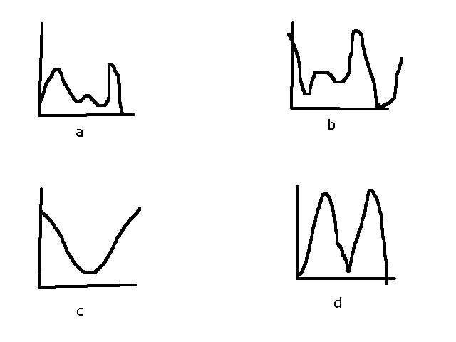

The probability densities are like this:
Something like this. c and d are useless. a and b.
a is similar to the potential given. b is the opposite.
Probability densities are square integrable. Is that the case with all the choices? Hint: No.
Of the ones that are square integrable, which one looks like the best candidate given that your potential looks like it does?
Also, don't expect the probability density to be similar to the potential, whatever that means.
