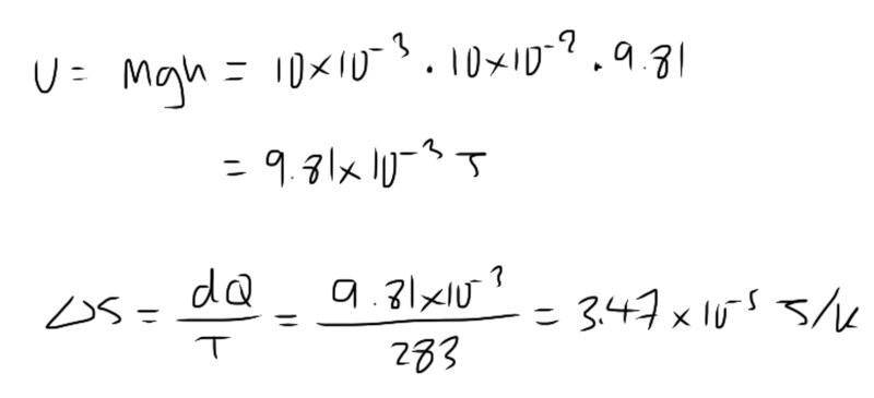

What is the probability that a 10g pencil lying on a table will spring spontaneously 10cm into the air at the expense of thermal energy of its surroundings which are at 15°C. What do you conclude from your result?
I’m guessing I’m supposed to calculate the gravitational potential energy, which comes from the thermal energy of the surroundings, but I’m not sure how that relates to probability. In my course I’ve only been given entropy equations, not sure how it relates to probability
dS = dQ/T
U = mgh
I

so_gr_lo said:
Homework Statement:: What is the probability that a 10g pencil lying on a table will spring spontaneously 10cm into the air at the expense of thermal energy of its surroundings which are at 15°C. What do you conclude from your result?
Relevant Equations:: dS = dQ/T
U = mgh
IView attachment 300690

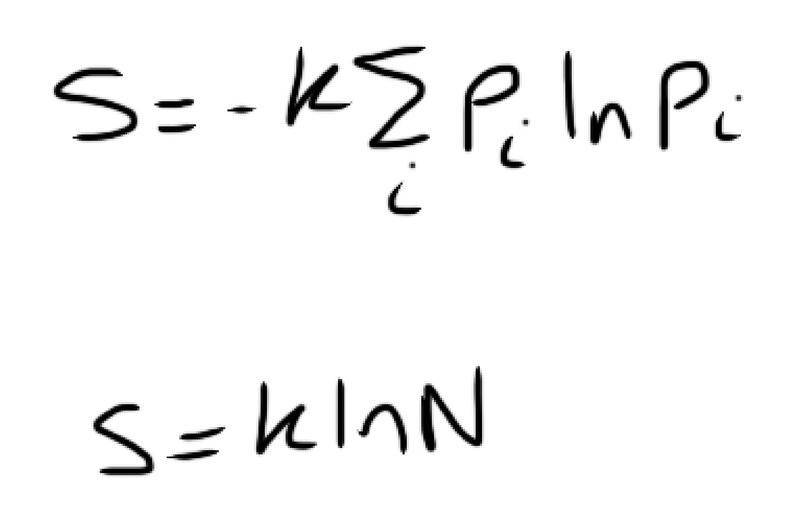

Entropy change is correct. For probability, you need to go back and look up your lecture note/book on energy partition function and Boltzmann factor.
These are the equations I have in my notes, are they the ones your referring to?
