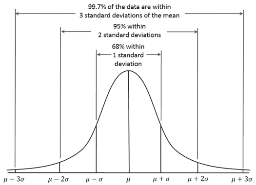

Given a capacitor with 33 nF
Task requires you to compute the probability for a capacitance being greater than 30nF, given that there's 20% tolerance (3σ).
The formula for Gaussian distribution (https://en.wikipedia.org/wiki/Normal_distribution)
Given the upper data, if the nominal value for capacitance is 33nF and tolerance of 20%, then values can range between 26.4nF and 39.6nF. With the bottom margin being set at 30nF, this means that the interval takes approximately 72% of all values.
Is this the correct procedure to solve this task?
Any sort of help would be appreciated.
No. How did you determine the 0.72 ?
By dividing the interval 30 - 39.6 from 26.4 - 39.6.
If you find the z-value associated with 30, meaning the number of ##\sigma## from the expected value, you can just look up the associated percent/percentile in a standard normal table. Edit: I am assuming from your post that the data in question are normally-distributed. Please let me know if that is not correct or must be proven first.
It would be clearer if you posted something like ' I did (39.6-30)/(39.6-26.4) = 0.727 '
Which is definitely not the idea of this exercise.
Another notion that needs correction is
because the exercise text clearly implies that the capacitance is distributed according to a normal distribution with average 33 nF and a standard deviation of 6.6/3 nF = 2.2 nF.
That means capacitances can range between ##-\infty## and ##+\infty## :woot:
(not to worry, the probabilities decrease very rapidly outside reasonable ranges. But theoretically they are not zero !)
Just a consequence of the assumed probability distribution model -- for which very good but not perfect arguments exist.
In fact, outside the range average ##\pm 3\sigma##, 0.27% of the values are theoretically expected.
Now, what are you supposed to do: given the average value of 33 nF and the standard deviation of 2.2 nF
Suppose you have a standard normal distribution plot in front of you ,
the probability to find any value corresponds to the total area under the curve: 1 (or also expressed as 100%)
the probability to find a value > 33nF corresponds to the area under the curve from 33 nF to infinity: 0.5 (from symmetry)
Can you describe what area corresponds to the probablity the exercise asks for ?------------------------------------
Another important bit of wise-guy comment:
What we casually call probablility distributions are actually plots of probability densities . Probabilities emerge when we multiply with a range: probability for a value to be in ##[x, x+dx]## is equal to ##P(x)\, dx##.​
