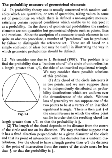

Forgive me, I am not a probability guy, so I am unsure how well known this is. I was trying to figure something out and found this. I found it cool.

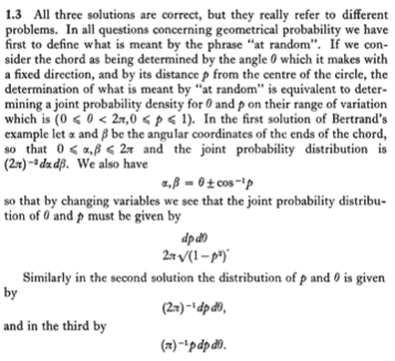

Here's the explanation.
The first solution is a fraction (damn scanner!)
Oops! From Kendall Geometrical Probability (1963)

The basic idea is reasonably well-known. For example, if we have two concentric circles of radii ##1## and ##2## and we pick a point "at random" in the larger circle, what is the probability it is in the smaller circle?
If we choose Cartesian coordinates uniformly, then the probablity is ##1/4##. But, if we choose polar coordinates, then the probability is ##1/2##.
When you use polar coordinates, the correct was (equal area) is uniform in angle and uniform in ##r^2## (not in ##r##).
