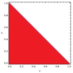

Like everyone else, I observed that without loss of generality, we may let the rod be of unit length.
Let $x$ be the length of the first piece, $y$ be the length of the second piece, then $1-(x + y)$ will be the length of the third. We know we must have:
\(\displaystyle 0<x<1\)
\(\displaystyle 0<y<1\)
\(\displaystyle 0<1-(x + y)< 1\)
Graphing these 3 inequalities, we find that we may represent the total sample space $S$ by the area bounded by the lines:
\(\displaystyle x=0\)
\(\displaystyle y=0\)
\(\displaystyle x+y=1\)
which is a right isosceles triangle of area \(\displaystyle A_S=\frac{1}{2}\). Each point in $S$ represents a possible partitioning of the rod. This area is shaded in red:

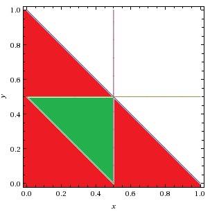

By the triangle inequality, we know all of the pieces must be less than 1/2 unit in length:
\(\displaystyle 0<x<\frac{1}{2}\)
\(\displaystyle 0<y<\frac{1}{2}\)
\(\displaystyle 0<1-(x+y)<\frac{1}{2}\)
Graphing these 3 inequalities, we find that we may represent these conditions by the area $T$ bounded by the lines:
\(\displaystyle x=\frac{1}{2}\)
\(\displaystyle y=\frac{1}{2}\)
\(\displaystyle x+y=\frac{1}{2}\)
which is a right isosceles triangle of area \(\displaystyle A_T=\frac{1}{8}\). Each point in $T$ represents a partitioning in which a triangle may be formed. This area is shaded in green:
Thus, the probability in question is:
\(\displaystyle P(\text{triangle is possible})=\frac{A_T}{A_S}=\frac{1}{4}\)
