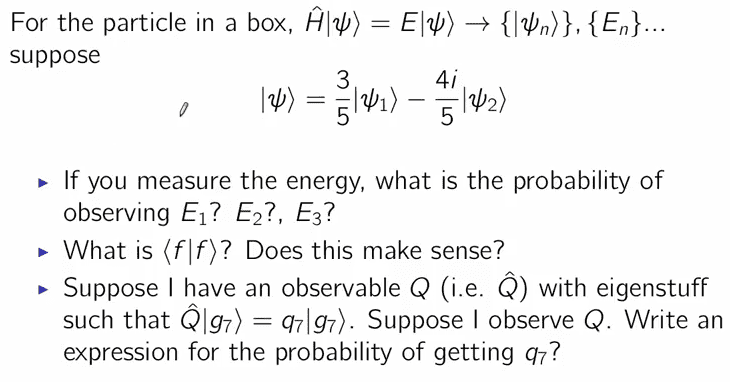

Since this is discrete, I know the probability is equal to ##|a_{n}|^{2}##, hence the probability of observing ##E_{1}##, ##P(E_{1}) = \frac {9}{25}##, and ##P(E_{2}) = \frac {16}{25}##. However, I just sort of remembered this fact, I am not sure how to prove that the probability is equal to the square of the absolute value of the coefficient.
For the second part, they pose a very good question, what in the heck is ##f##? I don't see any ##f## anywhere.
For the third question, shouldn't it just be ##|q_{7}|^{2}##?

There nothing to prove. This is simply the Born rule.
I see two possibilities: a typo, and its supposed to be ##|\psi\rangle##. Or its any state ##|f\rangle##, and you have to prove a general statement.

What is ##q_7## in the problem?
I'll just assume its for any state ##|f \rangle##,
Then $$\langle f|f \rangle = \int_{-\infty}^{\infty} f^{*}f \hspace{0.02 in} dx $$
And for question 3, I suppose ##q_{7}## is the operator ##\hat {Q}##

I guess that the question is asking you to push this further, considering that you have a particle in a box.
That's not correct. You have
\hat{Q} | g_7 \rangle = q_7 | g_7 \rangle
Can you identify all the elements in that equation?

The general idea is that if a system is in state ##\lvert \psi \rangle## and you want to calculate the probability you'll find it in the state ##\lvert \phi \rangle##, you calculate the overlap of the two states, ##\langle \phi \vert \psi \rangle##, which is called the probability amplitude. The probability is then given by the square of the modulus of the probability amplitude. Knowing this, you should be able to answer part (c).
By the way, ##q_7## is a number. It's definitely not the operator ##\hat{Q}##. What is its relation to ##\hat{Q}##? That's what DrClaude wants you to understand.
This is the question statement, I just copied it off a youtube video.
Assuming ##|g_{7} \rangle## is nonzero, they should cancel on both sides, hence ##q_{7} = \hat {Q}##. I know ##q_{7}## is an eigenvalue and ##\hat {Q}## is the operator, but I don't know what to make of it.
For question 2, I will revert to @DrClaude other idea, to replace ##f## with ##\psi##

You can't do that. Since one is an operator and the other a scalar, they can't be equal. If you want to calculate things in QM, you need to understand how eigenequations work. With the equation ##\hat{Q} | g_7 \rangle = q_7 | g_7 \rangle##, you are being told that there is an operator ##\hat{Q}##, of which one eigenvector is ##| g_7 \rangle##, with eigenvalue ##q_7##.
The question is not very well posed. Let me rephrase it: you have a system in state ##|\psi\rangle##. You measure Q, which corresponds to the observable (operator) ##\hat{Q}##. Write an expression for the probability of measuring ##Q = q_7##.

You are mixing two notations. If you have functions ##\phi(x)## and ##\psi(x)##, then you can calculate the scalar product as
\int_{-\infty}^\infty \phi(x)^* \psi(x) dx
In the Dirac notation, that scalar product is simply written ##\langle \phi | \psi \rangle##. The product of a bra and a ket is already an integration, and you can't have a ket as a function of position. Bras and kets are abstract representation of states.

Because it is an abstract state vector, that lives in a Hilbert space. To get a function of position, you need to calculate

If you know the position representation of the bras and kets, you can use that to calculate inner products, e.g., for the 1D harmonic oscillator eigenfunctions ##\phi_i##
\langle \phi_i | \phi_j \rangle = \int_{-\infty}^\infty \phi_i^*(x) \phi_j(x) dx
But you don't need to know that function representation, because since the eigenfunctions are othonormal, you get directly
\langle \phi_i | \phi_j \rangle =\delta_{ij}
In other words, you can (and should here) manipulate the kets as abstract state vectors.

The notation does not mean ##\langle a | b \rangle = b(a)##. I was referring to position eigenstates

Nothing, but that's not what you wrote before.
It may help to connect the new notation to what you've learned before. Suppose you have a vector ##\vec{a}##. In the new notation, you'd write ##\lvert a \rangle##. To keep things simple and familiar, let's say it lives in three-dimensional space. Now you decide how you're going to orient the x, y, and z axes. In linear algebra speak, you're choosing a basis. Once you've done this, it makes sense to talk about the x-component of ##\vec{a}## and so on, and you can now write
$$\vec{a} = a_1 \hat{e}_1 + a_2 \hat{e}_2 + a_3 \hat{e}_3 = \sum_{i=1}^3 a_i \hat{e}_i$$ where the ##\hat{e}_i##'s correspond to the unit vectors (basis vectors) pointing along the various axes. In the new notation, you'd write
$$\lvert a \rangle = a_1 \lvert 1 \rangle + a_2 \lvert 2 \rangle + a_3 \lvert 3 \rangle = \sum_{i=1}^3 a_i \lvert i \rangle.$$ To find ##a_i##, you'd calculate ##a_i = \hat{e}_i \cdot \vec{a}##. In Dirac notation, you have ##a_i = \langle i \vert a \rangle##. So finally we can write

Now let's go back to quantum mechanics… You have the state vector ##\lvert \psi \rangle##. The set of vectors {##\lvert x \rangle##} form a basis; they correspond to {##\lvert i \rangle##} in the previous example where ##x## acts as a label as ##i## did earlier. ##x## is continuous, so we replace the summation by an integral
$$\lvert \psi \rangle = \int \lvert x \rangle \langle x \vert \psi \rangle\,dx.$$ Just as each ##a_i = \langle i \vert a \rangle## is a number, ##\langle x \vert \psi \rangle## is a number. It's equal to the wave function ##\psi## evaluated at ##x##. That is, ##\psi(x) = \langle x \vert \psi \rangle##. You need to distinguish between the state vector ##\lvert \psi \rangle##, the wave function ##\psi##, and ##\psi(x)##, the value of the wave function maps ##x## to.
