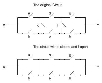

Hi Everyone,
below I've attached an embarrassing drawing of a circuit with switches. Signal enters from the left side at both line. Given that each switch has a 50% chance of being open, what is the probability of signal reaching the end of the circuit(far right)?
The answer that I got was 45/128 but I have a feeling its wrong.
Cheers.

So if you un-short the output, can you show us how you got your answer? The vertical switches can short out the signal as well, right? So you need the right combination of shorts and opens for the differential signal to get through. Looks to me like the probability of the differential signal getting through is quite low...
Maybe you already did this, but if not, what I would do is label the 8 switches (e.g., A, B, and C for the ones along the top, D and E for the ones that join the upper and lower branches, and F, G, and H for the ones along the bottom.
Determine all of the possible paths that the current could take.
ABC (p = 1/8)
ADGH (p = 1/16)
ADGEC (p = 1/32)
FGH (p = 1/8)
Once you get all of the possible paths from the upper left node, you can use symmetry to find the paths from the lower left node.
The overall probability should be the sum of the probabilities along the individual paths.

The following attachment is how I think the OP is expecting this interpreted. That is a simple "single wire" interpretation.
I get the following Boolean expression :
[ (A + BC) D + (B + AC) EF ] G + [ (B + AC) E + (A + BC) DF ] H
I'm too lazy to expand that into "min terms' by hand so I made a few lines of code to count them. I found the expression true for 84 out of the 256 possible switch combinations.

Good morning everyone. I found an error in my probability calculations and I now agree with uart that the probability is 84/256. Here's my probability calculations, using the labelling uart uses. I used the following boolean expression:
c'f'(adg+beh) + cf'(a+b)(dg+eh) + c'f(ad+be)(g+h) + cf(a+b)(d+e)(g+h)
Here's the probability for each term:
c'f'(adg+beh): 1/2*1/2*(1/8+1/8-1/64) = 15/256
cf'(a+b)(dg+eh): 1/2*1/2*(1/2+1/2-1/4)(1/4+1/4-1/16) = 21/256
c'f(ad+be)(g+h): 1/2*1/2*(1/4+1/4-1/16)(1/2+1/2-1/4) = 21/256
cf(a+b)(d+e)(g+h): 1/2*1/2*(1/2+1/2-1/4)3 = 27/256
Total: 84/256.

OK, I will explain how I got it. Here's a figure:
The switches at c and f are causing the problem by interrupting the "and-or" structure. So the idea is to break the circuit down into the four cases for switches c and f. Look at the second figure. Here I have illustrated the circuit where c is closed and f is open. In that picture you have a connection through the first section if a or b is closed; write that:
(a + b)
You have a connection through the second part of the circuit if either g and d are closed or e and h are closed. Write that:
(gd + eh)
To get a complete circuit you need the first half and the second half:
(a+b)(gd + eh)
Finally, this is all given c closed and f open, write that
cf'
You need them all true for this case, which gives the term:
cf'(a+b)(gd + eh)
That's how I got the second term of the expansion. There are three more states for cf. So see if you can draw the corresponding circuits and get the correct expressions.
[Edit] fixed typo cd should have been gd

Thank you, that's perfect. Thanks to uart too.
