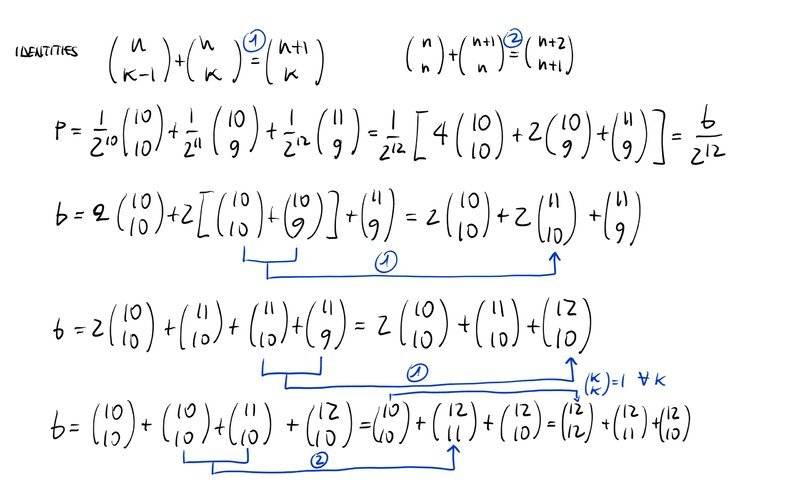

Hi, me again. I was able to prove the equivalence of the two different formulas giving [itex]79/2^{12}[/itex] using a couple of identities for the binomial coefficients I found out on the Wikipedia page. The second is actually a particular case of a more general sum identity.
Since it would take me some time to write it down in LaTeX I'm attaching an image of my calculation. It's just 3 steps. I'm using twice the first identity and once the second.
I wonder if this result could be generalized to something like
$$ \sum_{m=k}^{n-1} 2^{n-m-1} \binom{m}{k-1} = \sum_{m=k+1}^{n-1} \binom{n}{k} $$
with [itex]k>n/2[/itex]. I do not think I've seen something like that among the identities listed by the Wikipedia page, but if there something like that, it's listed somewhere.
with [itex]k>n/2[/itex]. I do not think I've seen something like that among the identities listed by the Wikipedia page.
I'm not quite sure what you're aiming for here? You certainly can use two different ways of modeling / solving the same problem to generate combinatorial identities. If that's of interest, go for it. It isn't really needed though.
Can I suggest that tackling a simpler problem may be useful? In particular, it maybe be instructive to try and re-run what I said against a simpler problem involving 'only' 11 games, i.e.
simpler problem: "Two players are playing against each other. They have the same probability of winning a single game. In order to win the match a player needs to win ten games. What is the probability that one of the players wins in 11 or less games?"
(Once you have a nice intuitive bridge between 10 and 11, you can fairly easily generalize to the 12 problem... ).
Hi,
It's only that I was surprised at the fact that the two very different formulas above give the same result. I tried playing around with the identities and it really took me a surprisingly little time to work that out. I guess I was excited about that, and I wanted to share "my" finding (surely it has been figured out long ago).
I am aware that what I did is pretty specific. I want to understand the general principles underlying the problem, and I'll look at what you suggest.
