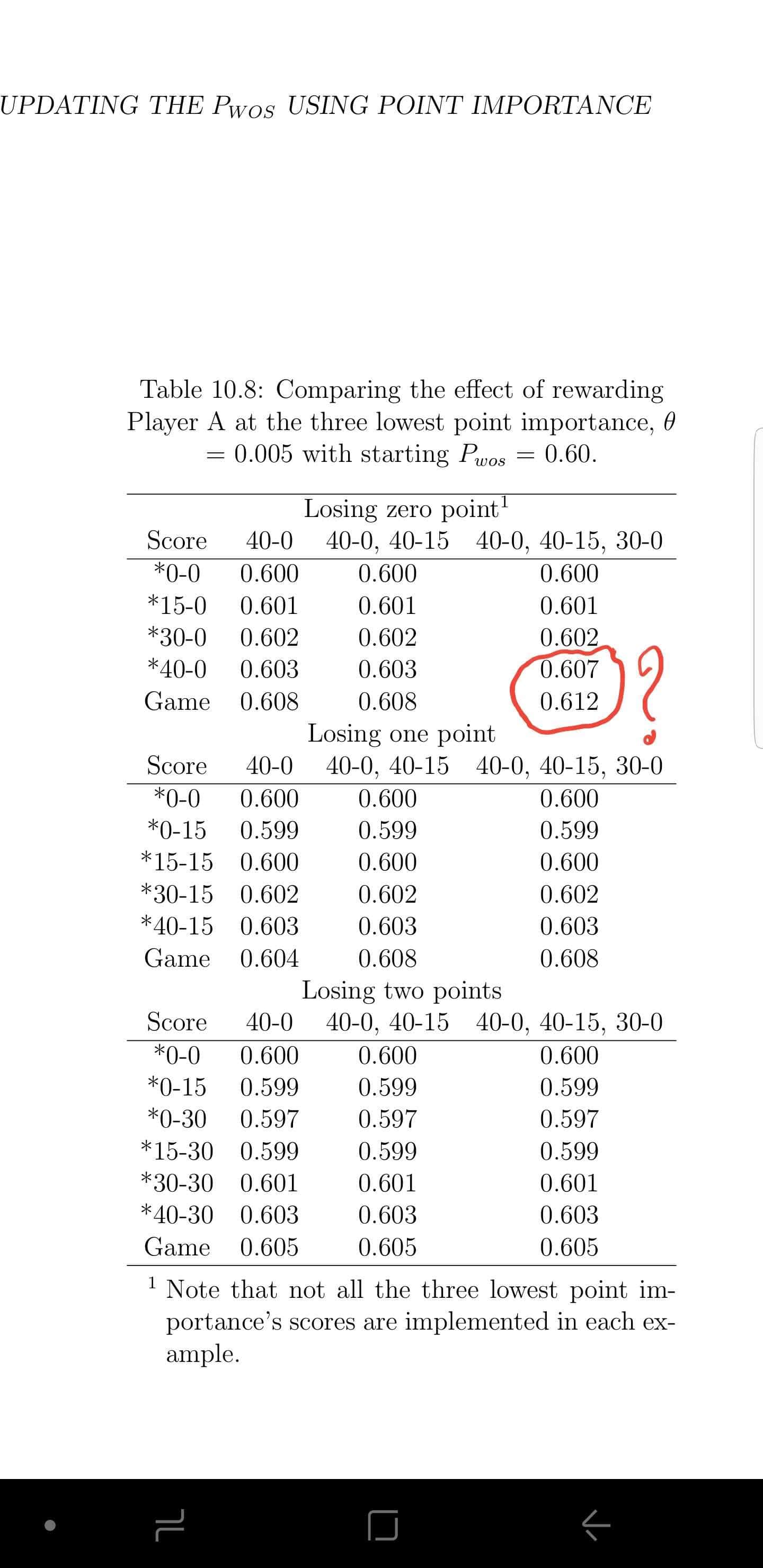

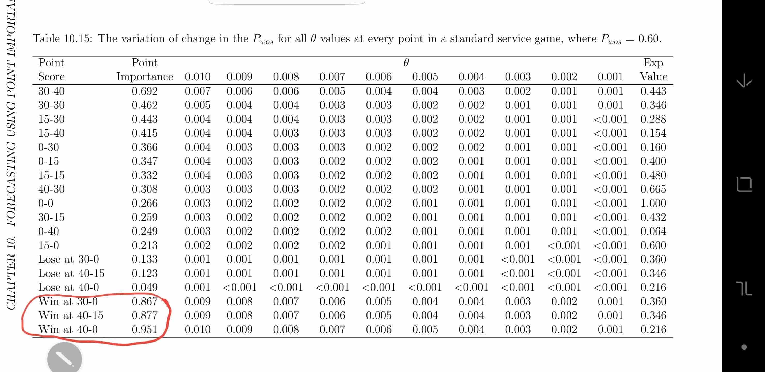

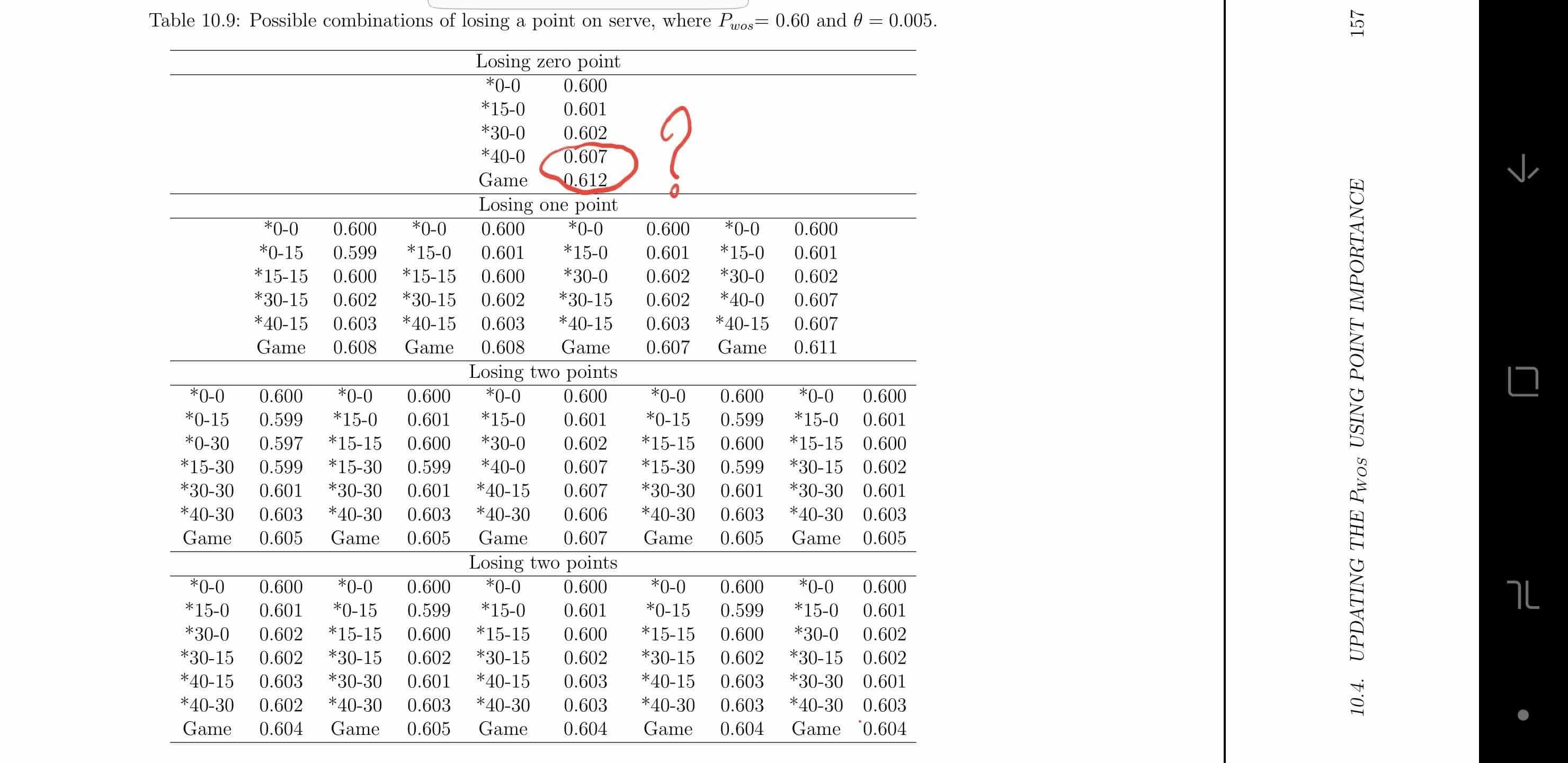

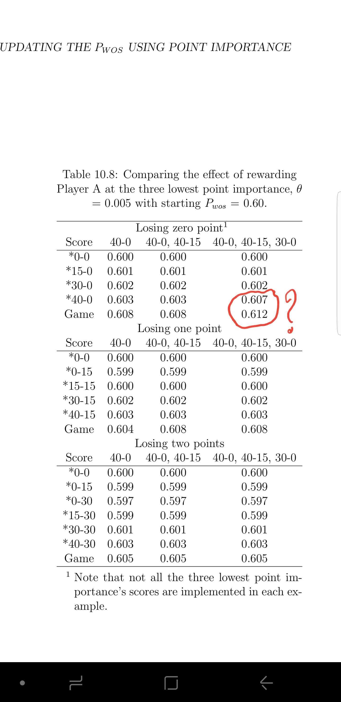

hello, I read the book "Prediction of In-Play Tennis" by Michelle Anne Viney. I have a question. this is about "UPDATING THE PWOS USING POINT IMPORTANCE" . the author says that when a player wins his game losing 0 points. his PWOS grows from 600 to 612. this means that the author uses twice the formula " PAwos(n)= PAwos(n-1)+(1-Ip(a,b))×Ɵ" in one game. initial Pwos=600, optimal(Ɵ)=0.005.
but i calculate with betfair and I see that it uses the formula
" PAwos(n)= PAwos(n-1)+(1-Ip(a,b))×Ɵ" just one time in a game , the rest of the time it uses this formula
" PAwos(n)= PAwos(n-1)±Ip(a,b)×Ɵ"
please tell me how to properly update Pwos with betfair?
I know that very few people can answer to this question...
Sorry for my English
I'm very grateful in advance...
