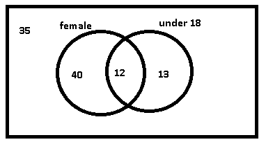

I made a typo. I said "male" where I meant "female" it should be 35% because 12% are females and 13% are males, not the other way around.
The Venn Diagram should have been as follows:
If you notice, once you make the Venn Diagram, it's much simpler to isolate groups and find what you're looking for.
The female circle should total 52 (40 + 12), the under 18 circle should total 25 (13 + 12), and the entire set should total 100 (40+12+13+35).

I fixed it. In the original problem we were told that 12% were females under 18. That's was given. so 25% (of under 18) - 12% (of females under 18) = 13% (of males under 18)

I really think the Venn Diagram would help a lot here. It's good at visually presenting all of the information.
