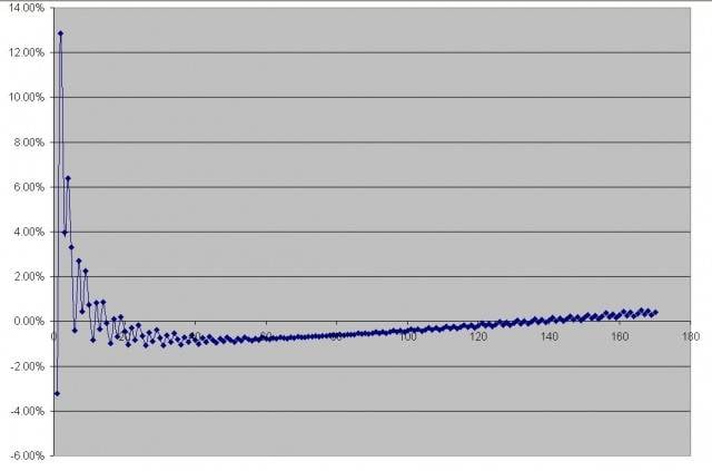

Looking at the error of normal versus the binomial up to N = 170 (M = floor(0.6*N+0.5)):
2015 sti 0 60
It actually gets worse after N = 140. Is it meant to?

Jonathan212 said:
So we want sigma = sqrt( N * 0.5 * ( 1 - 0.5 ) ). And the answer for N = 1000, M = 601 is 1 in 21 million. Hurray! That's statistically significant as hell.
Looking at the error of normal versus the binomial up to N = 170:
2015 sti 0 60
I'm taking a guess that the normal distribution, being essentially ##e^{-x^2}##, will fall off to zero faster than the binomial. So, after a certain point the relative error will increase, but relative to some very small probabilities.

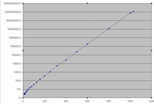

Indeed Excel's cumulative binomial runs out of steam at N = 1029, it fails above that value. But so does Excel's normal distribution at N = 1555 (the cumulative option). Btw the source of my true random data is not Excel but /dev/random or "haveged".
  • #34
The plot looks alright though.
X-axis = N
Y-axis = 1 / probability that N throws result in >=N*0.6 heads.
