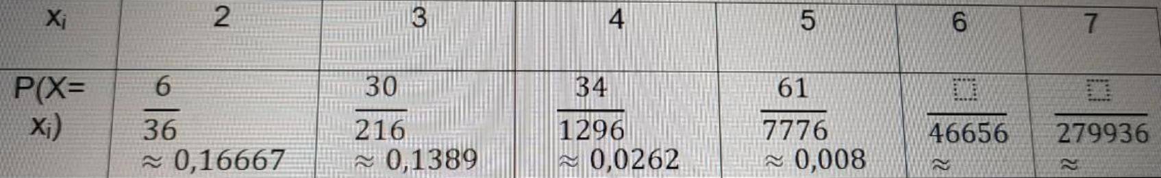

I understand that pattern! (Nerd) But I saw now the following table:
Can this table be correct? In this table we don't have that pattern. (Wondering)

Indeed. That table looks incorrect.
All probabilities must sum up to 1, which isn't the case in that table either. (Worried)

So, that table is in general incorrect? Or just for this example? (Wondering)

The table looks incorrect in general.
In theory it could still be correct, but only if the entries entries for 6 and 7 are unexpectedly high to compensate. (Nerd)

Ah ok! Do the numberators have a specific pattern? The denominators are of the form $6^k$. (Wondering)

Just the one that we've already found, which equals $\frac{6!\cdot (x_i-1)}{(7-x_i)!}$. (Thinking)

Do you mean at the initial example or the fractions of the table of the picture? (Wondering)

Ah, you meant the numerators in the table. (Tmi)
I don't see an obvious pattern.
Since $34=2\cdot 17$, and since $61$ is prime, it's clear that some kind of OR operation would be involved, but I don't see which one could apply.
We might see the binomial coefficients $6,15,20,15,6,1$ in there, but those don't really add up either. (Thinking)
