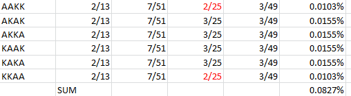

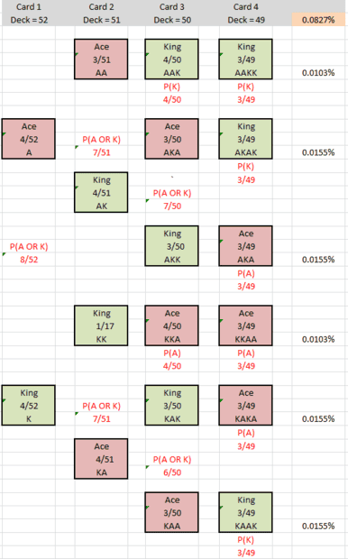

So, I don't expect you to change your response from last time, but I do have a question. I have replicated what I did in a long form:
1. I think that for the first two cards, I do not mind whether I pick an Ace or King. Correct?
2. When I draw cards 3 and 4, the probabilities vary, depending upon whether my first two cards were the same (AA or KK) or different. Correct?
So, if I am making an error, it is with the probabilities that I am assigning to drawing an Ace or a King for cards 3 and 4?
Thankyou.
AAKK
8/52​
7/51​
4/50​
3/49​
0.0103%​
AKAK
8/52​
7/51​
6/50​
3/49​
0.0155%​
AKKA
8/52​
7/51​
6/50​
3/49​
0.0155%​
KAAK
8/52​
7/51​
6/50​
3/49​
0.0155%​
KAKA
8/52​
7/51​
6/50​
3/49​
0.0155%​
KKAA
8/52​
7/51​
4/50​
3/49​
0.0103%​
SUM
0.0827%​
No, your error is that you are conflating two different methods of getting to the same result. In the first line of your table you have written "AAKK" so you want the probability of the first card being an ace. Why have you written 8/52 as the probability for the first card?
Edit: And in your spreadsheet probability tree you have written the correct probabilities in the box for each card (the red numbers outside boxes are irrelevant). Why have you not multiplied 4 x 3 x 4 x 3 / 52 x 51 x 50 x 49 for the first line?

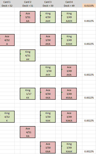

Thank you for that.
So, my first mistake was in my original Combination calculation that I thought I had correct. I calculated 36/ 270,725 as equal to 0.133%, whereas it is 0.0133%. In trying to replicate the same wrong answer using probabilities I ignored logic and tried magic and brute force instead.
I take your point that I tried using two different methods of calculation in the same table. My logic was that for the first two draws I do not mind whether I get an Ace or King, so the probability is 8/52 x 7/52 (any Ace or King will do). Then, in the example of drawing AAKK, I can only draw a King for the third card and a King or the fourth card, so I used the probability 4/50 * 3/49. So, that would be P(Ace or King) * P(Ace or King) * P(King) * P(King). I believe that this is wrong because I am confusing random probabilities P(Ace or King) with specific outcomes P(AAKK).
Having determined that there are 6 possible ways to draw two Aces and two Kings, then having listed them, I should have calculated the probability of each of those specific outcomes. So, in the case of P(AAKK) it is P(Ace) * P(Ace) * P(King) * P(King), not P(Ace or King). I then sum the probabilities to get 0.0133%.
The correct table is below, along with the long version. I am a little cautious still of saying that I have got the method of this correct, even though the answer is 0.0133% probability of drawing any two Aces and two Kings out of 52 cards using either method. If you could confirm that I have this correct, it would be appreciated. Incidentally, I assume that I could also have calculated this starting with P(Ace or King = 8/52) instead of P(King = 4/52), but I would have had to change the process for cards 3 and 4? Thank you.
The reason that I did not get the correct answer with (4 x 3 x 4 x 3)/ (52 x 51 x 49 x 48) is because I was calculating the probability of only one event, such as P(AAKK), in the numerator. In contrast, in the denominator I was calculating the probability of every permutation of drawing 4 cards out of 52, in every different order. I should have multiplied the numerator by 6, converting the single permutation into a Combination; or divided the denominator by 6, to do the reverse.
AAKK
4/52​
3/51​
4/50​
3/49​
0.0022%​
AKAK
4/52​
4/51​
3/50​
3/49​
0.0022%​
AKKA
4/52​
4/51​
3/50​
3/49​
0.0022%​
KAAK
4/52​
4/51​
3/50​
3/49​
0.0022%​
KAKA
4/52​
4/51​
3/50​
3/49​
0.0022%​
KKAA
4/52​
3/51​
4/50​
3/49​
0.0022%​
SUM
0.0133%​
