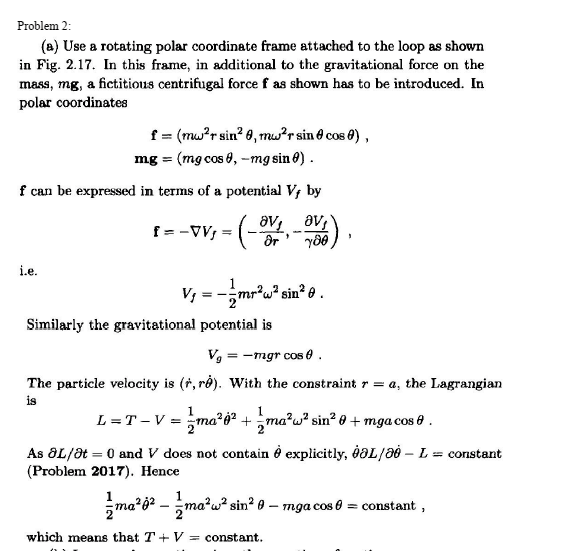

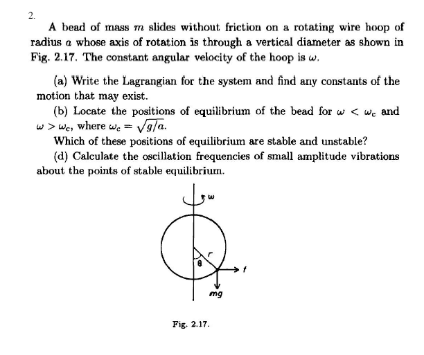

Here I have a tutorial problem as follows:
The problem I have is about part a, whose answer is as follows:
When I solve the partial derivative on Vf w.r.t. r, I get Vf = mω^2rsin^2(θ)/2 +g(θ), where g(θ) is a function of θ.
However, when I take the partial derivate on Vf w.r.t. θ, I get mω^2r^2sin(θ)cos(θ)dθ/dt + dg(θ)/dθ. This is different from the centrifugal force in θ dimension and I am confused.

There is a typo in the solution: the ##\gamma## in the denominator should be an ##r##.
When I do ##\bigl (\nabla V_f\bigr )_r = {\partial V_{f,r}\over \partial r}\ , \ ## I get ##\ m\omega^2 r\ sin^2\theta##
Probably because I have a different idea what ##\nabla## is in polar coordinates.Oops, too long typesetting .. bravo kuru !
[edit] but there is an ##r## too many in ##-m\omega^2r^2\sin\theta\cos\theta## ...​
How would you proceed to find ##g(\theta)##? You will have to solve $$\frac{1}{r}\frac{\partial }{\partial \theta}\left[\frac{1}{2}m\omega^2 r\sin^2\theta+g(\theta)\right]=m\omega^2r^2\sin\theta\cos\theta.$$What does that give you for ##g(\theta)##?

There is no need to consider centrifugal force. Write the kinetic energy T relative the lab frame and the potential V of the force mg; L=T-V.
$$T=\frac{1}{2}m((\dot \theta r)^2+(r\omega\sin\theta )^2),\quad V=-mgr\cos\theta$$

Yes I was also confused as to why they use a rotating frame. To make it more difficult? It's a good exercise in any case though :wink:

And also derivatives in r are meaningless ; ##\theta## is only generalized coordinate
