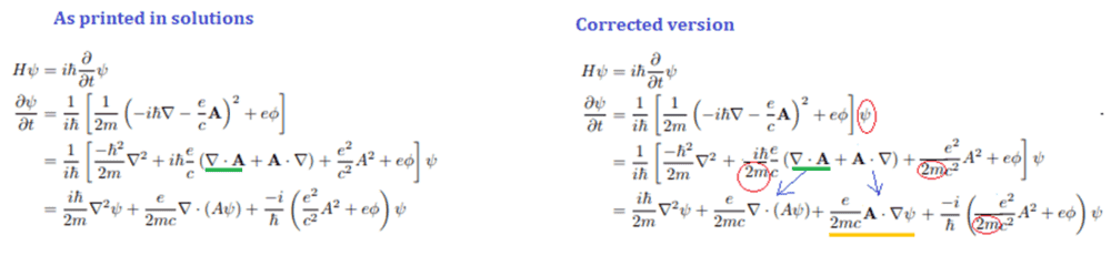

Another said:
Could you clarify the difference in meaning of "##A##" and "A" (going from lines 1 and 2, to line 3, in your attachment)? It looks like a scalar has changed to a vector.

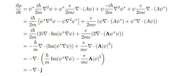

this is full solution
http://www.physics.drexel.edu/~pgautam/wf/PHYS517/PHYS517HW1.pdf
You can see this problem in problem 2b in above link
I think ##A## is modulus of vector potential ##A = \sqrt(A^2)## and A is a vector quantities of vector potential vector A = A_x i + A_y j + A_zk

This equation is not correct.
As @Abhishek11235 noted, there are several errors in the printed solutions. All of the ##A##'s should be boldface except for the terms with ##A^2##.
Here are the errors I found in the first few lines of the solutions:
In the next to last line, I've underlined a term in green. It's important to note that the divergence operator in this term acts on ##\mathbf A \psi## and not just on ##\mathbf A ##. So, you can see that the original solution is missing a term in the last line, which I underlined in yellow in the corrected version.
Similar corrections occur for the conjugated equation. With these corrections, you should be able to eventually get the desired result for ##\mathbf j##.
