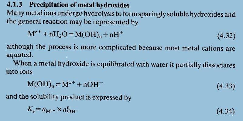

Borek said:
No, you are making the same error again and again. Please check with your textbook.
I believe it is right as below. THANK YOU VERY MUCH!
H+ + OH- = H2O Kw
Ni(OH)2= Ni2+ + 2OH- Ka
so, for Ni2+ + 2H2O = Ni(OH)2 + 2H+
K = Kw^2/Ka
Borek said:
Refer to the textbook page attached.
Ni(OH)2 = Ni2+ + 2(OH)-
Ks = [Ni]2+ x (OH)-^2 = 10^(-12.73)
Ni+ ranges from 1 to 0.01M, so OH- can be calculated accordingly. Is this right now?
Yes, when you have a correct formula for Ksp it is as trivial as solving for OH- and converting it to pH.
Thank you very much indeed!
looking back I think I was confused initially by the way it was given,
Ni 2+ + 2H2O <-> Ni(OH)2 (s) + 2H+
and forgot to go to the definition of the solubility product. this is a good lesson learned.
