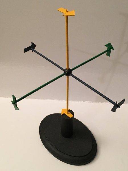

Please help me solve a problem that has puzzled me for years. I am not a mathematician or a physicist, so please bear with me. Imagine the apparatus pictured to be a depiction of the x, y and z axes. The x is represented by the green stick. The y is represented by the yellow stick, and the z by the blue stick. Let’s place an arbitrary range of each axis as -10 to +10. At -10 and +10 of each axis is a potential force represented by the arrows. When applied, it will be a constant force, such that when initiated in one axis only to the points at -10 and +10 that axis would scribe a circle. Now imagine a hypothetical sphere “enclosing” the apparatus whose x, y and z axes would correspond exactly to the x, y and z axes of the stationary apparatus. The imaginary sphere will never move, and will serve as a reference or standard. So the center of the imaginary sphere is x=0, y=0 and z=0…the same co-ordinates of the center point of the stationary apparatus. Now, apply an equal and constant force to each axis in the direction of their arrows at exactly the same moment. With no “knowledge” of the other axes, anyone axis will always “think” that it is fulfilling its mission of scribing a circle. Please forgive the anthropomorphism.
Questions:
Will the center point of the apparatus remain at the center point of the imaginary sphere or be displaced in a particular direction?
Since the end points of each axis will no longer scribe a circle, what will be the trajectory of each end point?
Will the end points of each axis scribe identical paths?
If this force could be applied indefinitely, would the end points eventually scribe a sphere?
If you reverse the direction of the forces on just one axis, how will it affect the behavior of the apparatus? Thank you!

Surprisingly, the problem turns out to be much easier than it looks.
As described, a rotation is imparted to the rigid object in each of the three indicated directions.
The thing that simplifies all this is that rotations can be represented as vectors, pointing along the axis of rotation, and rotations add just as vectors do!
The rotations applied to the yellow, green and blue rods are represented by vectors, all the same magnitude, pointing in the green (away from us), blue (towards us) and yellow (down) directions.
The sum of those vectors is a vector pointing to the right and about 35 degrees below the plane of the blue and green rods. The magnitude of the vector is the length of the internal diagonal of a cube whose edges are the lengths of the individual vectors, which is ##\sqrt 3## times those lengths.
This means that the whole assembly will rotate around an axis aligned in the direction I described, at a rate that is ##\sqrt3## times each of the individual rotation rates. The central point of the assembly ('the origin') does not move.
In 3D space the combined rotation vector has its tail at the origin (0,0,0) and its head at the point (1,-1,1).
If one of the component rotations is reversed, the sign of the respective component of the vector (1,-1,1) is reversed, so that the vector retains its length but points to a corresponding point in a different octant (just as in 2D there are four quadrants in the number plane, in 3D there are eight octants).
The six end points will describe two circles around the axis of rotation, three of them (the two leftmost ones and the top one as we look at the picture) describing a circle along a line of Latitude in the Southern Hemisphere of the sphere (like a Tropic of Capricorn). and the other three following the Tropic of Cancer. Here I sue North and South as determined by the direction of rotation, using the same convention as is used with the Earth, not by the up and down directions in the photo.

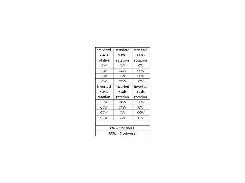

Andrew, if there are 8 possible directional combinations of force (torque) applied in the model, as shown in the chart below, and the “inverted” combinations cancel out the “standard” combinations, then there should be 4 possible axes of rotation. Is this finally correct? If so, I have one remaining question: Is there a formula that could be applied to the original model such that the torque values could be tweaked (no longer be equal) so that (0,0,0) in the model remains at (0,0,0) of a fixed imaginary reference sphere? We stated earlier that the end points of the x, y and z axes rotating around the new resultant axis would scribe a circle (at the end points) and a cone (including the line segments of each axis) with (0,0,0) being the apex of the cone. Basically, I want to know if the model could be spun in such a way that the end points would eventually scribe a sphere.
Jim Lundquist said:
A.T., torques are equal on all three axes and continuous, as if the arrows shown in the OP were rocket engines.
Yes, that gives you a total torque along one of the unit cube diagonals.
