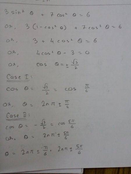

Find the general solution of the Trigonometric equation: $$3\sin ^2 {\theta} + 7\cos ^2 {\theta} =6$$
Given andwer: ##n\pi \pm \frac {\pi}{6}##

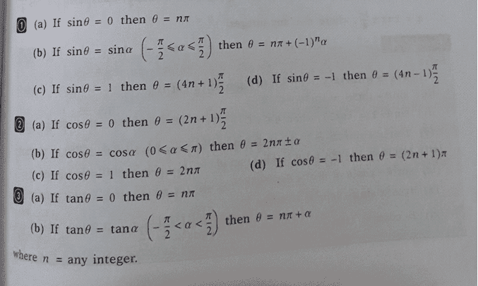

These equations may help:
:[/B]
Please see the pic below:
It seems correct from my side, but the answer is not matching.
Is there really a difference :smile: ?
Couldn't understand... could you explain a bit...
Fill in n = 1, 2, 3 in both expressions (yours and the book one) :rolleyes:
Likes Wrichik Basu
There is a pi radian difference between -pi/6 and 5pi/6, same with pi/6 and -5pi/6. So you can just say it is +-pi/6 + n*pi, where n can be any integer. That covers all of your scenarios.

Why don't you let Wrichik make that discovery himself ?
Likes Wrichik Basu
understood. Thank you.
Thanks. I guess I didn't see your response about plugging in 1,2,3, etc when I wrote my suggestion.
