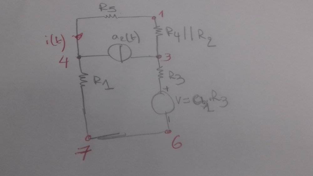

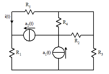

Hi all!
while simplifying this diagram, I thought that R2 and R4 are in parallel
while
so I simplified the diagram to this
BUT THE SOLUTION CONSIDER THAT R4 AND R2 HAVE BEEN COUR CIRCUITED!
Any help would be highly appreciated particularly a rule of thumb that helps me to identify a short circuit with a fault!
many thanks in advance!
In your top schematic, R5 R4 R2 R3 all share a common node. In your "simplified" schematic, this feature has been lost, so it is not equivalent.
Likes Amaelle
thank you! BUT HOW COULD THEY SAY THAT R4 AND R2 ARE SHORT CIRCUITED?
DID they say, "R4 and R2 are court circuit" ? Else what did they actually say or show in a diagram?

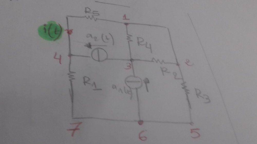

They are in parallel. They are significant and not short circuited. But your diagram is in no way equivalent to the original circuit. You have removed the connection between R3 and R5. In your diagram you have connected R3 to the opposite end of R2 and R4 from the original diagram.
I would suggest you label the nodes and note which nodes the components connect to.
Likes Amaelle
thanks a lot for your prompt reply,
let start from the begining:
the exercice ask to calculate the current i(t)

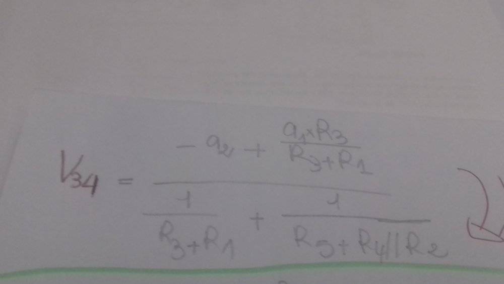

so i simplified the circuit as follow considering that R4 and R2 are parallel ( the circuit is not equivalent to the first but i guess the value i(t) will not change (please correct me if I'm wrong)
then I simplified further the circuit by using the conversion between the current generator a1(t) and it's voltage generator equivalent

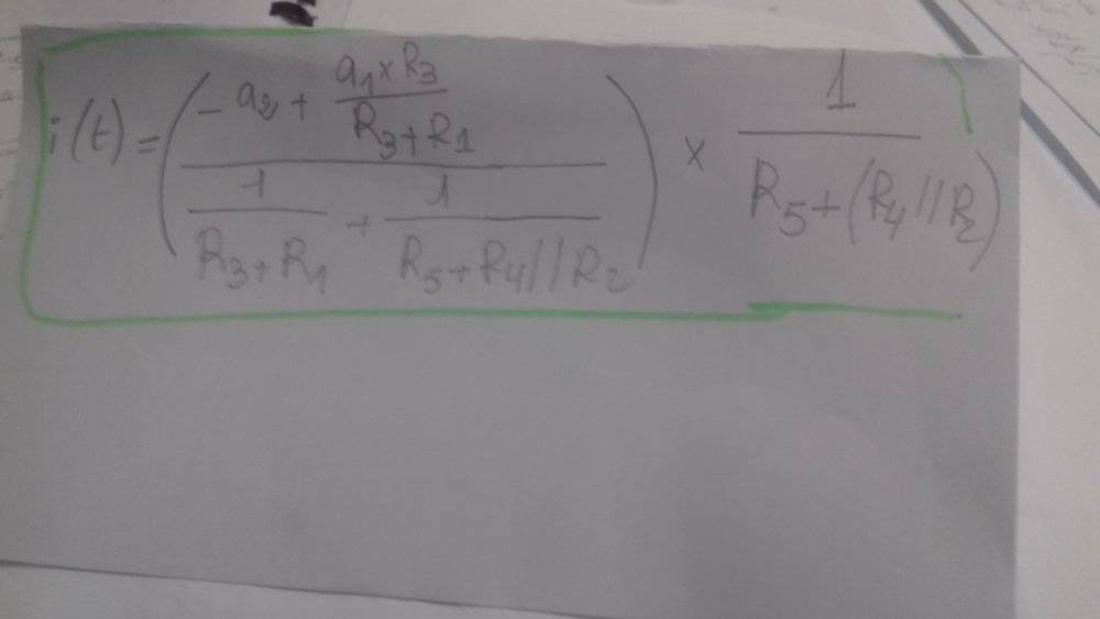

after this step I used millman theorem to compute the potential between the nodes 4 and 3
and then divide by the resistance of the branch to find i(t)

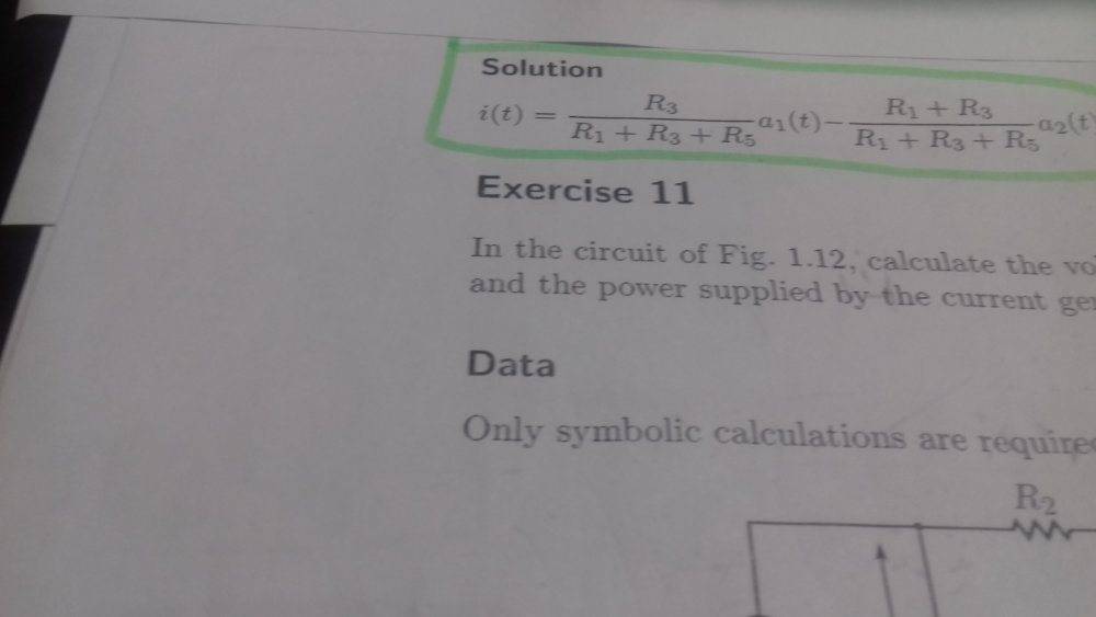

the problem is that in solution they totally ignore R4 and R2 as they short circuited!

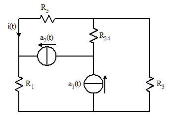

If you begin with:
and combine R2 with R4 you get this:
  • Love
Likes Amaelle
you are awsome! thanks a million you totally solved my problem! God bless you!
