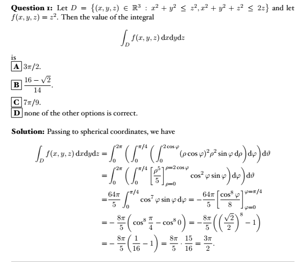

Good day I have the following exercice and it's solved using spherical coordinates
I totally agree with the solution but I have issue to find out why mine does not work

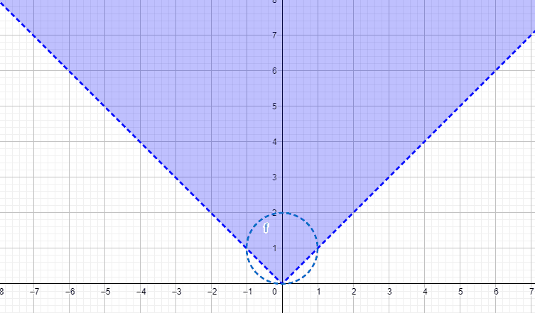

How did you decide that those two regions A1 and A2 were the correct regions to plot? Try plotting [itex] r = \sqrt{x^2 + y^2}[/itex] vs z for the two conditions given. What is the shape of the resulting region?
Ignore that post. I think you have the regions correct. Another question. Why did you integrate from r=0 to r=√z in the first integral. Shouldn't it be from r=0 to r=z?

this is the region I'm getting
the cone region I have gotten by calculation the integral from r= 0 to r=sqrt(z)
and the half sphere region that I got from r=0 to r=sqrt(2z-z^2)

Please look at the edits to my post. I agree the regions look correct, but I think you made two errors in evaluating the integrals. Correct those and see what you get.
