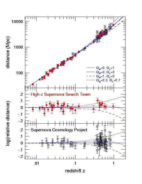

In summary, the graph shows the relationship between redshift and distance for a constant, accelerating and decelerating expansion of the universe. It's hard to tell because the page you linked to is very sparse, but it appears to show that light from a far galaxy is more redshifted than light from a nearby galaxy.
JohnnyGui
796
51
I was looking at the following graph showing the relationship between redshift and distance for a constant, accelerating and decelerating expansion of the universe.
Source
Looking at the accelerating expansion line (red), I tried to reason why it would show a line that deviates upwards from the proportional one. I reasoned that it was so because, as a galaxy is further away, we would receive an older light, at the time when the galaxy was receding at a slower recession velocity than it was now. Thus, we receive the redshift based on an older (slower) velocity, meaning that redshift would not change too much as expected with a fixed increase in distance, making the line go upwards.
However, even though this reasoning gives me the expected line, when reviewing this reasoning I noticed that this is the ordinary Doppler shift which is not similar to the cosmological one. The problem is that when I reason according to the Cosmological Redshift, my conclusion tends to collide with the above graph.
My reasoning in the case of the cosmological redshift is as follows. In addition to redshift being based on the recession velocity, during the travel of emitted light towards us, its redshift would also adapt to changes in the expansion rate that occurs during that travel. Such that the redshift that we receive is representing the net result of recession velocity at the time the light was emitted + the changes in expansion rate until we received that light.
Thus, redshift of emitted light from a nearby galaxy would be based on a relatively small change in acceleration of the expansion until we receive it. In contrast, redshifted light of a very far galaxy, that is emitted a long time ago, is based on a large change in accelerated expansion rate since it was longer subject to it during its travel towards us.
Therefore, I’d conclude that light of a very far galaxy would be more redshifted than light of a nearby galaxy. And this would lead me to reason that the graph line for an accelerated expansion rate would have to deviate downwards from the proportional line since a fixed distance increase would give a larger redshift.
This reasoning does not match the accelerating graph line since it deviates upwards instead. The only explanation I could think of for this is because Cosmological Redshift is a combination of redshift based on the recession velocity + change in expansion rate, in such a way that the change in expansion rate was not sufficient to compensate for the relatively low recession velocity back at the time the light was emitted. However, this explanation would make a decelerating expansion rate show an even more upwards deviating line.
I would like to know where and why I reasoned wrong.
That's not what it shows. Look at the label of the y axis. It says "relative intensity of light". The relationship between that and distance is model dependent, so you can't just interpret the graph as comparing the redshift-distance relation for different models.
Also, you need to give a source for this graph. We can't discuss it if we don't know where it comes from and what the context is.

It also shows "Relative Distance" on the y-axis on the right side of the graph.
Source added to OP.

Yes, but without units. I think that's because, as I said, the relationship is model-dependent, so they can't put units of distance in because there is no single relationship between light intensity and distance that applies to all three models shown in the graph.
It's hard to tell because the page you linked to is very sparse. This source appears to be focused on just summarizing facts, not teaching theory. You might want to try a cosmology textbook for a better understanding.

Here's a plot with distance shown, from two research teams. Source.
The dotted line above the straight one implies an accelerating expansion. If this is a reliable graph, then my OP is directed at this one instead.
One way to tackle this kind of issue is to examine the extremes. Consider two cases: a flat universe with only a cosmological constant, and a flat universe with only matter. If you run through the calculations, the function for distance vs. redshift for the first case is:
[tex]D_M = {c z\over H_0}[/tex]
Sweet, simple, to the point. This comes about because if you only have a cosmlogical constant, then the Hubble parameter is also a constant, so ##v = Hd## is a simple equation rather than a differential equation.
The matter-only case is a bit more complicated. Here ##H## changes over time (H decreases rather quickly as the universe expands), and that complicates the calculation. The answer ends up being, provided I did my math correctly:
[tex]D_M = {2 c \over H_0} \left(1 - {1 \over \sqrt{1+z}}\right)[/tex]
You can use Wolfram to to graph these:
https://www.wolframalpha.com/input/?i=plot+d+=+z,+d+=+2(1-1/sqrt(z+1))
Note that for all values of ##z > 0##, the matter-only case (the reddish line), the distances are smaller for the same redshift.

They don't say which distance it is (there are different ways to measure the distance of observed objects like galaxies, light intensity is not the only one), but from the surrounding text I think it's luminosity distance (i.e., the intensity of the light we receive from the object). So it's basically the same as the graph you linked to in your OP. The problem is that converting this to an actual distance "now", i.e., how far away the object is from us at this instant of cosmological time, is model-dependent. The article does not appear to go into that. But as far as I can tell, it's still an issue, and it means you should not just interpret the "distance" in the graph as a spatial distance; it's more complicated than that.
The article also doesn't go into the dependence of the relationship between observed brightness and redshift, which depends on the spatial curvature in the model. The "constant expansion" empty universe has a different spatial curvature (open) from the "accelerating" and "decelerating" ones in the graphs in both of the articles you linked to (which are spatially flat). So that's another confounding factor.
Aside from the above, I think the key error you make in your OP is to try to separate out "Doppler" from "cosmological" redshift. The best way to interpret the redshift is the factor by which the universe expanded from emission to reception; more precisely, ##1 + z## is that factor, where ##z## is the redshift. So a redshift of ##1## means the universe doubled in size from emission of the light to reception (us seeing it). With that interpretation, it might be easier to see why the relationship between observed brightness and redshift is what it is for the different models.
For the purposes of this kind of plot, the specific distance used doesn't matter much. Typically they all differ from one another by some power of ##(1+z)##. Multiplying or dividing by ##(1+z)## won't change the relative ordering of distance between objects.

That's the factor that I have been using. I'm trying to reason how redshift from a nearby galaxy would differ from a far one when I consider cosmological redshift being based both recession velocity plus changes in expansion rate.
One could describe this in a scenario of an observer receiving at t = 0 both old light from a far galaxy and recent light from a nearby one, at the same time. Let's say the old light has been emitted earlier at t = -100, at the time the expansion rate was relatively low, and ever since that time the expansion is accelerating. At t= -10, that old light passes a nearby galaxy and at that same moment the nearby galaxy emits its relatively recent light, such that both old and recent light arrive at the same time at the observer. At t=0 the observer receives both lights at the same time. Old light emitted at t=-100 came from a time when the expansion wasn't really fast but was longer subject to acceleration, recent light emitted at t=-10 came from a relatively faster expansion but was shorter subject to acceleration. Which of the 2 lights received is more redshifted, i.e. which of the 2 factors (time of emission vs duration of being subject to acceleration) "wins"?
EDIT: I also noticed that even in case of a constant expansion rate, if an observer receives both old and recent light from a far and nearby galaxy at the same time, he would calculate different H values. The old light is based on when the far galaxy had a high velocity at a smaller distance compared to the recent light that is based on a smaller velocity at a larger distance, since the universe expanded (at a constant rate) in the meantime. This makes me wonder how there's even a linear relationship between redshift and distance in case of a constant expansion while the observer should measure different H values depending on distance because there's a time factor in all this.

This is a misconception that might be throwing you off the track - whether our universe was in the accelerating stage or not, the rate of expansion (i.e. the Hubble parameter) always was and always will be going down. It would be going down even in an empty universe, and it would be constant only in a universe containing solely dark energy in the form of the cosmological constant. It would grow only if that dark energy wasn't constant, but also growing.
The accelerated expansion refers to the growth of the scale factor, not the expansion rate. It means that as the rate goes down, it approaches some positive, non-zero value, where reaching this rate in the far future is tantamount to achieving exponential growth of the scale factor.
This bit suggests another misconception.
Even if the expansion rate in the past weren't always decreasing, the redshift would still be more pronounced in light emitted from further away (= earlier), because redshift is the integrated result of expansion, and there was no time in the history of the universe when it was not expanding.
Using your example of older light joining more recent emissions: by the time the old light passes by the younger emitter, it has already accumulated some redshift due to the expansion the universe underwent during that time. Whatever additional redshift will be accumulated from that point onwards, equal in magnitude for both signals, will be added to the earlier effect. In case of the younger emission there's no pre-existing effect to add to, so older light will be always more redshifted.
The only possible case where the older light would arrive at the observer less redshifted than the younger one would be if by the time the two signals are joined together, the old light was blueshifted - i.e. if it had been traveling through a contracting universe that then started to expand.
Going back to the graph in the OP, since we know that the expansion rate is going down faster in universes with higher mass density, then light with some observed redshift would have to be emitted at different distances depending on that density - the denser the universe, the closer the emission (because in order to reach the current rate of expansion despite all that matter strongly decelerating it, the universe would have to have higher initial expansion rate, and consequently for a given emission distance, scale factor would have grown more and light would have accumulated more redshift).
Conversely, the lower the matter density (= higher proportion of dark energy density), the farther the emission must have been for the observed redshift. This is exactly what the graph shows.

Redshift is only impacted by the amount of expansion between us and the source. If distances in the universe have doubled, then the wavelength of light has doubled, meaning the redshift is ##z=1## (since wavelengths are multiplied by ##z+1##).

And the point I was trying to make was that you can't split up the redshift into "recession velocity" and "changes in expansion rate". That doesn't work. You have to treat the redshift ##1 + z## as simply telling you by what factor the universe expanded from emission to reception of the light--you can't split it up into parts.
It seems I'm associating the H value too much with the plot. Assuming that measuring different H values at the same time should break the proportionality between z and distance.
I realized that I'd like to understand this further by knowing how the ratio of the observed wavelength/emitted wavelength is calculated in case of an accelerating expansion, expressed in terms of velocity change (acceleration), distance and time. I understand in case of a constant expansion ##\frac{\lambda'}{\lambda} = 1 + \frac{H_0D}{c}##.
How do I calculate ##\frac{\lambda'}{\lambda}## in case of an accelerating expansion where the initial recession velocity ##H_0 \cdot D## changes over time? Do I have to integrate it over the time? Such that I'd have to integrate:

I think I have found the culprit of my misunderstanding. I wasn't considering the plot in my OP to be the measured redshifts of different galaxies/stars at one moment in time.
When I noticed this, I used my earlier described scenario of receiving light from a star ##A## at a smaller distance and receiving light from star ##B## at a larger distance, both at the same moment during an an accelerating expansion. Using an initial Hubble value and distances ##D_A## and ##D_B## of the stars, all at ##t=0##, I deduced a formula for the time ##t## at which the light of star ##B## would pass star ##A## while ##A## has been accelerating towards the light of star ##B##, by solving the quardratic equation: ##ΔD = H_0\cdot D_At + \frac{1}{2}at^2 + ct##. So that both lights would travel along each other towards earth.
Combining this with the increase in distance specific for star ##A## and ##B## until each of their light arrives at earth, I was able to conclude that for the redshift of both stars, ##z_A## and ##z_B##, that if acceleration ##a > 0## then:
$$ z_A \cdot \frac{D_B}{D_A} > z_B $$
and if ##a < 0## (deceleration):
$$z_A \cdot \frac{D_B}{D_A} < z_B$$
Setting either the Hubble value or the distances of star ##A## and ##B## as variables always satisfies this.

Ok, got it.
PeterDonis said:
You're still not getting it. There is no "extra property". There is no "regular Doppler shift". There is only "redshift". What the redshift represents depends on the specifics of the spacetime geometry and the light and the object emitting the light and the observer receiving it. It doesn't depend on whether it is a "redshift due to expansion" or a "regular Doppler shift". When we say that the redshift we observe in light from distant galaxies tells us how much the universe has expanded while the light traveled, we mean that that's what that redshift means given that particular spacetime geometry (the FRW spacetime that describes our universe) and those objects within that geometry.
Thanks for the explanation but I'm not sure if you understand what I'm saying. I googled and the last paragraph in this link is basically what I meant. I understand that regardless of the difference, in the case of cosmological redshift you can't split it into different forms of redshift.
PeterDonis said:
If spacetime is flat, there is no "accelerating expansion". That term describes a particular curved spacetime geometry. Change the geometry and you change what the redshift means. So your question doesn't make sense; you are basically asking "what does the redshift mean if spacetime is flat but isn't flat?" which is nonsense.
You're right. Let there be a spacetime according to an accelerating expansion (curved). In that case, can the following question then be answered: If light is emitted from a source, and during its travel towards the observer, the source has accelerated due to an accelerating expansion, will that redshifted light still represent a correct ##\frac{ΔD}{D}## upon arrival to the observer, including the influence of acceleration on ##ΔD##? According to the link I gave above, the answer seems to be yes?
That paragraph is not a good source if you actually want to understand the physics involved. The redshift we observe in light from distant galaxies is not because the emitting galaxies moved away from us while the light was traveling, which is what that paragraph implies; the rule that what happens to the emitter doesn't affect the light once it's emitted holds just as well in cosmology as anywhere else.
Thinking of the light as being "stretched" by the expansion is better as a heuristic, since it at least makes it clear that it has nothing to do with the emitter having some effect on the light after it's emitted.
What does ##\Delta D / D## mean? How would you measure it?
PeterDonis said:
What does ΔD/DΔD/D\Delta D / D mean? How would you measure it?
WIth ##\frac{ΔD}{D}## I mean the increase in distance ##ΔD## in ##\frac{D}{c}## time with respect to the original distance ##D## it moved from.
If one calculates ##D## using luminosity and knows the Hubble value ##\frac{D}{c}## time ago and how it changed over time until receiving the light, one could calculate ##\frac{ΔD}{D}## and check if it equals ##1 + z## and ##\frac{Δ\lambda}{\lambda}##.
If this is all not possible to do, how can one be sure that redshift represents the factor by which the universe expanded in the first place?
The distance ##D## that you calculate using luminosity is not the distance "now". Nor is it the distance when the light was emitted. Nor is the time the light took to travel equal to ##D / c##. The curvature of spacetime means you can't use this simple interpretation of any of these quantities.
Also, the "distance" itself is coordinate-dependent, as it is in any curved spacetime. When cosmologists talk about "distance", they mean distance in the standard FRW coordinates used in cosmology. But this "distance" can't be measured directly, because we don't have rulers billions of light years long, nor could we see where the distant galaxies fall on those rulers "now" even if we did.
What cosmologists actually do is to look at the relationships between the quantities that are observable: redshift, luminosity, and angular size are the main ones. We then compare those observed relationships with the relationships that are predicted by various possible spacetime geometries, in order to figure out which of those possible geometries represents the actual spacetime geometry of our universe. The distance ##D## is something we calculate after all of that has been done--i.e., it's just a number that cosmologists use as a convenient shorthand to describe the model the data says is the right one. It's not something we use to determine which model is right. We can't because, as above, we can't measure ##D##.
Because all of the possible spacetime geometries that could describe our universe have that property. So no matter which model our observations tell us is the right one, the redshift will represent the same thing. But note that, as above, this ratio of distances ##D## at reception and emission is not something we directly measure. So this property of the redshift is not something we can check by observation. Like the distances themselves, this property of the redshift is just a useful way of describing what it means in the model. It's not a test we make to see which model is right.

I see. Never looked at it that way. So basically, the whole subject is actually about discussing the behaviour of redshift and ##ΔD/D## that our model(s) would predict.
But according to our model, light does get affected by the change in expansion rate during its travel, even after it has been emitted by the source? Or is this also not true?
  • #32
JohnnyGui said:
So basically, the whole subject is actually about discussing the behaviour of redshift and ##\Delta D / D## that our model(s) would predict.
Yes.
That's a matter of interpretation. The math can be interpreted as saying this, but it can also be interpreted as saying the light doesn't change at all with expansion, what changes is the "direction in spacetime" of the observer that will receive the light.
