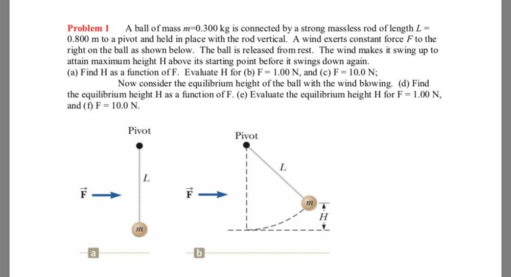

A ball of mass m=0.300 kg is connected by a strong massless rod of length L = 0.800 m to a pivot and held in place with the rod vertical. A wind exerts constant force F to the right on the ball as shown below. The ball is released from rest. The wind makes it swing up to attain maximum height H above its starting point before it swings down again. (a)Find H as a function of F. Evaluate H for (b)F=1.00N,and(c)F=10.0N;
There is a photo attached of the problem in totality.

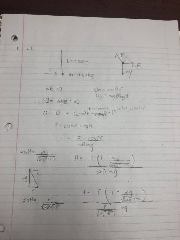

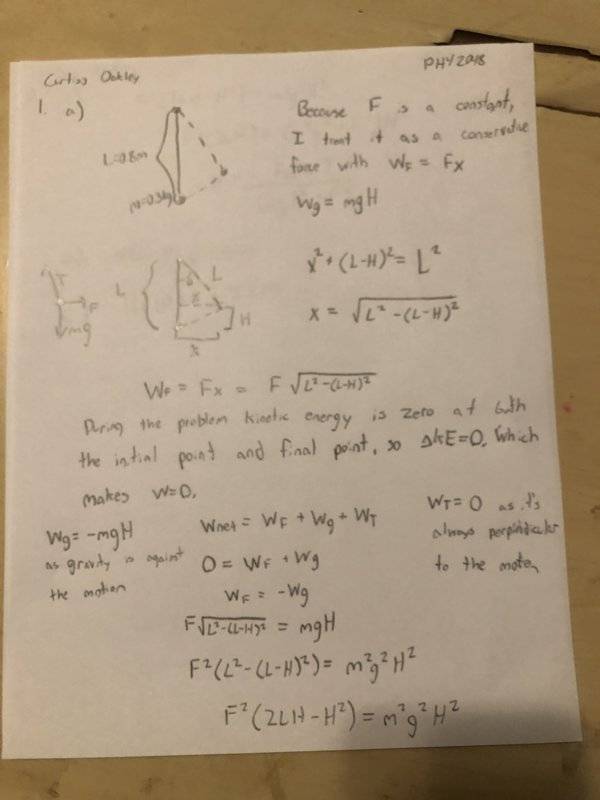

There has to be something wrong with this work (document attached) as it lacks the length of the rod, so if anyone is willing to correct my assumptions/tweak something I’m more than happy to hear it out. Thank you all so much for helping though!

The drawing that you attached in #1 says that the length of the rod is ##L##.
I was referring to my answer on the document attached, let me edit my comment to clarify.
I see. Look at the last drawing, bottom left of your drawing. Label angle ##\theta.## When the pendulum is released, at what angle from the vertical is the equilibrium position? At what angle from the equilibrium position is the maximum displacement? Once you have answered these questions, draw a "length" instead of a force diagram. Draw length ##L## along its initial vertical position and then again along its maximum displacement position. Use trigonometry to find ##H##.

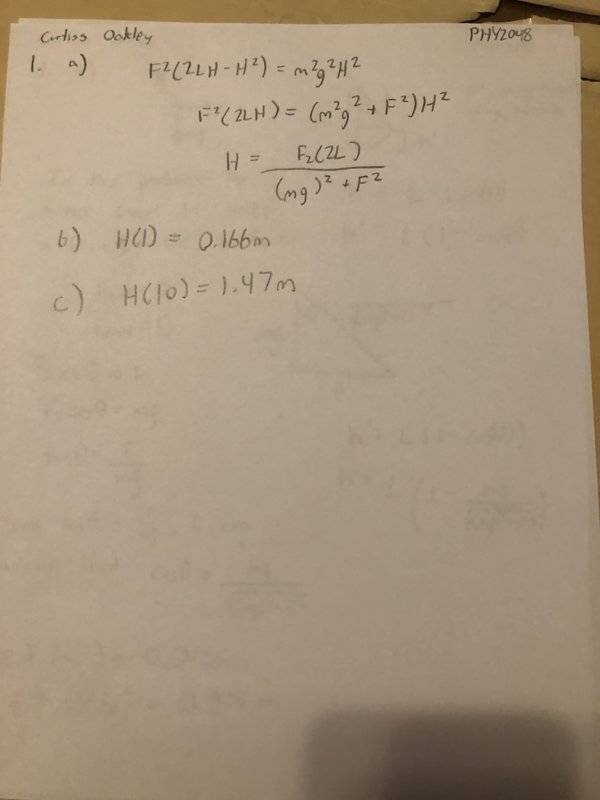

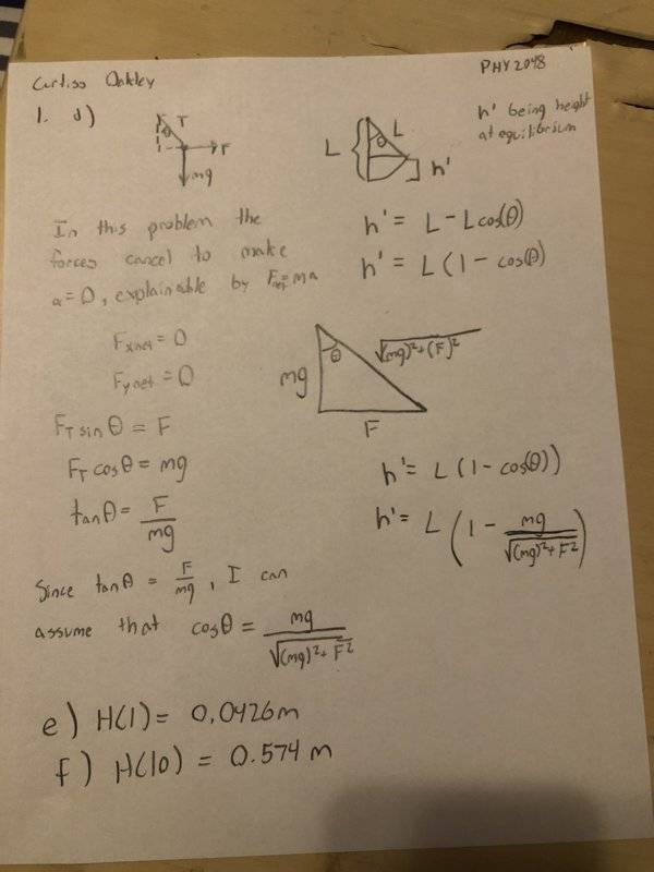

Thank you all for the fantastic help! I attached my final answer for any person that may want to get direction and ideas with a similar problem.
Your numbers agree with mine.
