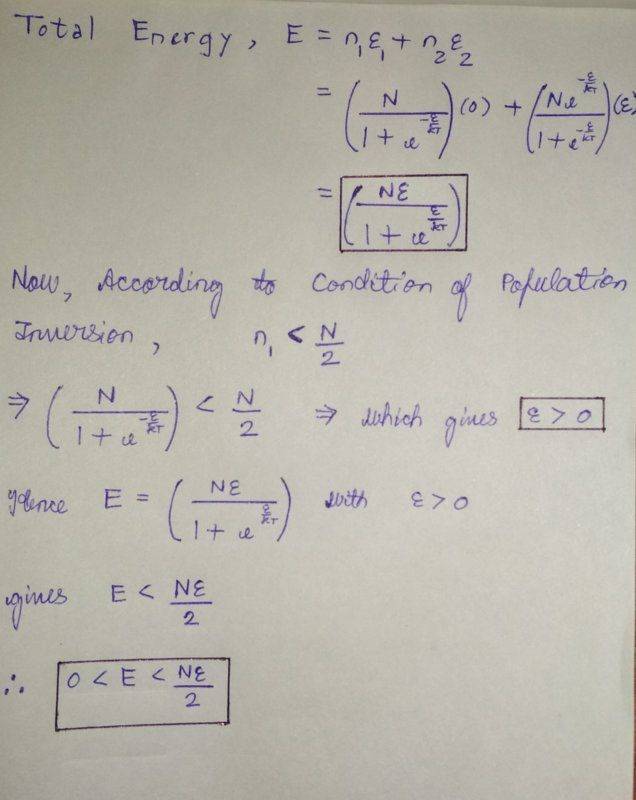

Total energy, E = n1ε1 + n2ε2
= e-ε/kt/(1 + e-ε/kT) × Nε
which is Nε/(1 + eε/kT)
There is no need to introduce temperature explicitly. You need to consider only that it is negative, and therefore that ##n_1 < N/2##.
Using ε > 0, I am getting total energy, E < Nε/2
It means that the energy of the upper level must be greater than (2/N) times the total energy E of the system.
Is this the answer of first part ?

that is not the form of answer requested. Your answer should be a range of values of E in terms of N and ε
haruspex said:
Yes, but that is not the form of answer requested. Your answer should be a range of values of E in terms of N and ε
It means 0 < E < Nε/2
How do you get that?
You have n1 < N/2 < n2. What is E in terms of n1, n2 and ε?

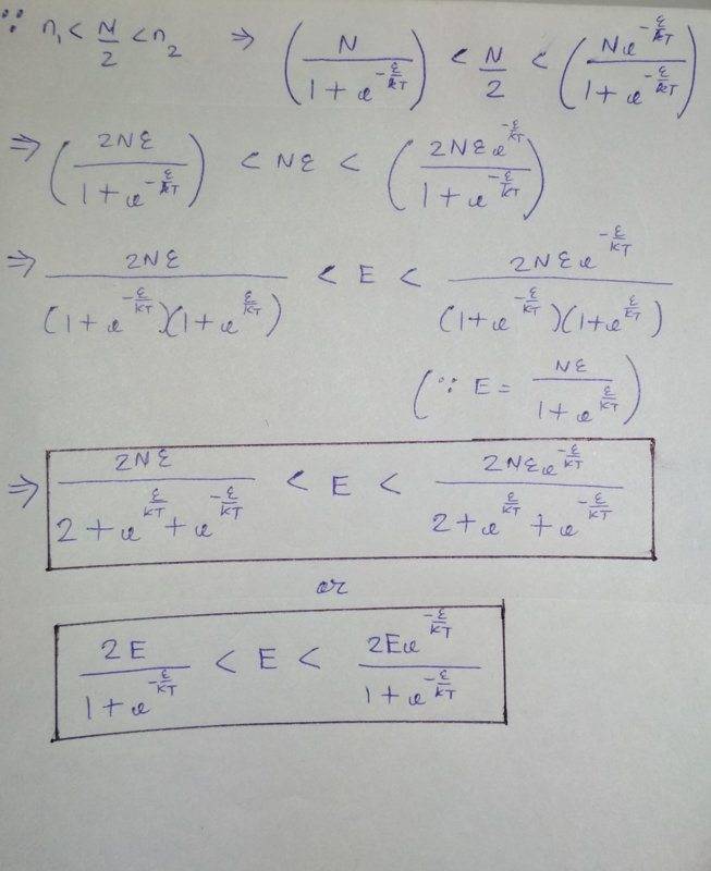

On applying n1 < N/2 < n2 and using E = n2ε = Nε/(1 + eε/kT)
I am getting 2ε/(1 + e-ε/kT) < ε < 2εe-ε/kT/(1 + e-ε/kT)
which becomes eε/kT < ε/2 < 1
You are making it far more complicated than it is. You need an inequality involving E, N and ε. Only. Don't involve T.
You were fine this far:

haruspex said:
You are still making it far too complicated and you should not have T in your answer.
Just use n1 < N/2 < n2 and E = n2ε, no other equations, to obtain an inequality relating only E, N and ε.
n1 < N/2 < n2
=> (N-n2) < N/2 < n2
Using E = n2ε => n2 = E/ε
=> N - E/ε < N/2 < E/ε
Adding (E/ε - N/2) all sides,
=> N/2 < E/ε < 2E/ε - N/2
=> Nε/2 < E < 2E - Nε/2
Is this correct?
Is this correct?
No. You can't have E on both sides of an inequality for E.
