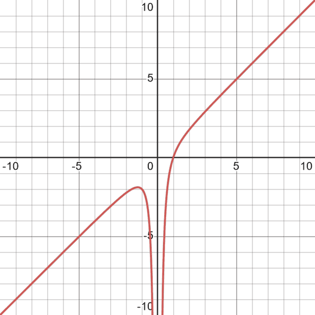

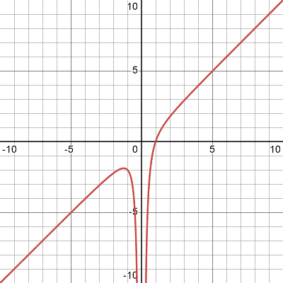

I'd like to add to what @erobz and @haruspex have said.
If ##R## is the earth’s radius the tension can be expressed as
##T(h) = m\omega^2(R+h)~ –~ \frac {GMm}{(R+h)^2}##
This is an equation you derived, except you incorrectly used ##h## instead of ##R+h##.
You can see the dependence of tension on ##R+h## by considering the general shape of a curve such as ##y = x – \frac 1{x^2}## (where ##y## represents ##T## and ##x## represents ##R+h##.
Here's a plot of ##y = x – \frac 1{x^2}## produced using Desmos:
Note that there is no minimum at the point where tension (##y##) is zero. (Also, negative values of ##x## have no physical meaning in the present context, but do give rise to a local maximum in the graph.)
That's easy to explain. Imagine a rigid rod rather than a cable. Negative values of ‘tension’ correspond to compression; so values of 'tension' which are less than zero are valid. Zero tension is not a minimum.

Steve4Physics said:
I'd like to add to what @erobz and @haruspex have said. If ##R## is the earth’s radius the tension can be expressed as ##T(h) = m\omega^2(R+h)\frac {GMm}{(R+h)^2}## This is an equation you derived, except you incorrectly used ##h## instead of ##R+h##. You can see the dependence of tension on ##R+h## by considering the general shape of a curve such as ##y = x– \frac 1{x^2}## (where ##y## represents ##T## and ##x## represents ##R+h##. Here's a plot of ##y = x– \frac 1{x^2}## produced using Desmos: View attachment 336748 Note that there is no minimum at the point where tension (##y##) is zero. (Also, negative values of ##x## have no physical meaning in the present context, but do give rise to a local maximum in the graph.) That's easy to explain. Imagine a rigid rod rather than a cable. Negative values of ‘tension’ correspond to compression; so values of 'tension' which are less than zero are valid. Zero tension is not a minimum.
