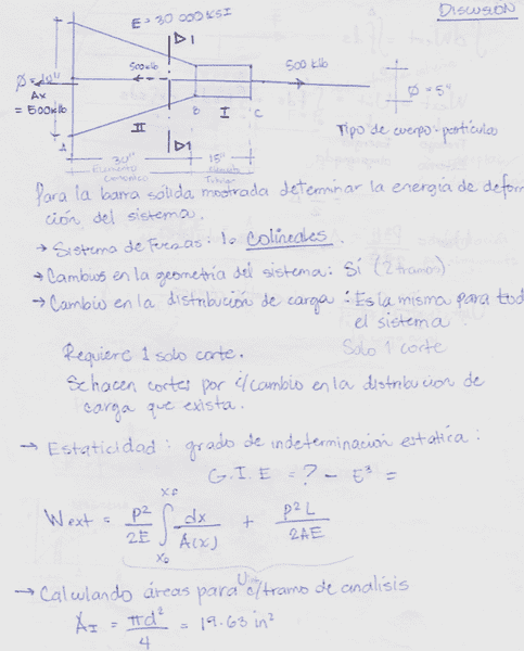

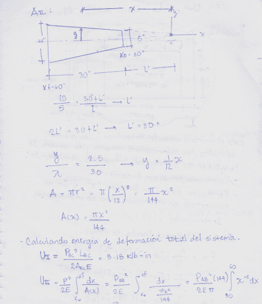

I think I understand, but there are some exercises in which is valid to take the zero down or away from the element considered. For example in this exercise (strain energy) and I only integrate in the real part of the element. So when will know whether it is valid or not take away the element origin?
It's valid as long as you are consistent. Your problem was that in different equations you were measuring h from different origins.
