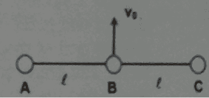

Three identical balls (of equal masses) are connected by light inextensible strings and kept on a smooth horizontal surface. The middle ball B is given a velocity ##v_0## at ##t=0##. Find the velocity of ball A when A collides with C.
Impulse ##J=\Delta P##
Since there is no net external horizontal force on the system, acceleration of Centre of Mass along ##x## is zero. Also, ##v_{cm,x}=0##.
Velocity of A and B along the string should be equal to ##v\sin\theta## so that the string does not extend.
Along ##x##, velocity of A is ##v\sin\theta\cos\theta##. If I can assume that all three balls have small radius, the final velocity of A will be equal to velocity of B which varies due to tension.
I tried using work-energy theorem but initially Tension is impulsive and the velocity of A and B increase suddenly. (I am not sure about this but I learned I can't use work-energy theorem when there is a sudden increase in velocity after reading one of the insight articles)
That leaves me with conservation of momentum of the system. Momentum of ball A or C cannot be conserved due to tension. But I am finding it difficult to get the equation.
You may want to forget about equations to begin with and try to figure out an important constraint that must apply when ball A collides with ball C.
Likes Titan97
Since length of string does not change, ##x^2+y^2=L^2##. then ##x\frac{dx}{dt}+y\frac{dy}{dt}=0## Is this the equation @PeroK ?
When they collide, x=0.

What I meant is, just when the ball are about to collide, the velocity of the two lower balls will be only along ##y## and will be equal to that of velocity of B.
Your last statement is the key. The velocity of the balls (in the y direction) when they collide must be equal to the velocity of ball B.

More likely, conservation laws.
It will have a component along x. But its velocity along y should be equal to velocity of ball B
Right.
What conservation laws can you apply?
Conservation of momentum in a direction perpendicular to string?

The benefit of conservation laws is that they allow you to relate the starting state to the final state directly, without having to worry about what goes on in between.
Yes, momentum will be conserved, but remember that momentum is a vector, so in a 2D set-up that is effectively two equations.
What else will be conserved?
Momentum of the system can be conserved. But for ball A, tension is an external force. So how can momentum of ball A or C can be conserved individually?
I'm not suggesting their momenta are conserved individually. In terms of the unknown final velocities, write out the initial and final momenta for the total system.
Initially, its ##3mv_0## along y-axis.
Finally, its ##3mv## along y-axis and 0 along x-axis?

Initially, a total mass of 3m has a velocity ##v_0## upwards.

This is not correct, only the middle ball has an initial velocity.
##v_{cm}=\frac{mv_0}{3m}##
So initial momentum is mv0/3 ?

No, initially you have one moving mass of mass ##m## which is moving with velocity ##v_0##. What does that mean for the initial momentum?
Likes Titan97
Its ##mv_0##. Finally, along y-axis, its ##3mv## where ##v## is the final velocity of any ball along y-axis.

Right. You need another equation. What else is conserved?

The velocity of the ball A and C suddenly increases. So Energy can't be conserved (just like the chain problem). But no external force acts on the center of mass. So energy of the system can be conserved.

Why do you think so? The initial velocities of A and C are zero.

There is no tension at the initial moment.
Likes Titan97
I understand now.
$$mv_0=3mv$$
$$v=\frac{v_0}{3}$$
$$\frac{1}{2}mv_0^2=\frac{1}{2}mv^2+2\cdot\frac{1}{2}m(v+v_x)^2$$
$$v_x=\frac{v_0}{\sqrt{3}}$$
$$|v_A|=|v_C|=\sqrt{v^2+v_x^2}=\frac{2v_0}{3}$$
