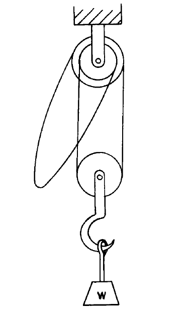

The differential pulley shown (vide the figure in the attached file) uses chain with N links per ft. The upper pulley has indentations which match the chain links, the larger sheave having n notches in its circumference and the smaller sheave, (n - 1) notches. (Each notch corresponds to two chain links.) The friction in the system is such that the ratio of the forces needed to raise or lower a weight W are in the ratio R. Assuming that the friction is the same in each direction, find the forces needed to raise W and to lower W.
Given answers:
Force needed to raise W = W*R / [n*(R - 1) + 1]
Force needed to lower W = W / [n*(R - 1) + 1]
1) Gravitational potential energy for one object = weight * height
2) Change in energy = force * (distance the force acts through)
3) Kinetic energy = (1/2)*m*(v^2)
4) Principle of conservation of energy
5) Principle of virtual work
Let the radius of the larger sheave in the upper pulley be r1, and the radius of the smaller sheave in this pulley be r2.
Given, the larger sheave has n notches in its circumference and the smaller sheave, (n - 1) notches.
Therefore, 2*pi*r1 corresponds to n notches, and 2*pi*r2 corresponds to (n - 1) notches.
Therefore, r1/r2 = n/(n - 1) ---> (1)
Also given, F(raising) / F(lowering) = R ---> (2)
Let, when the weight is raised or lowered, the upper pulley turns an angle x.
Then, the distance through which the weight displaces = (r1 - r2)*x = [{n/(n - 1)}*r2 - r2]*x = x/(n - 1).
After this, I have not been able to make further progress.

You need to relate the work done by the user to the useful work done. If the weight is raised distance y, what is the useful work done? How does that relate to the friction and the actual work done by the user?
It appears to me that if the weight is raised a distance y, then
the useful work done = W*y
Actual work done by the user = F(raising) * y
Work done by friction = F(friction) * y
Now, if we say that
Useful work done = Actual work done by the user - Work done by friction,
then we have
W*y = F(raising) * y - F(friction) * y
Then, dividing the LHS and the RHS of the equation by y, we have
W = F(raising) - F(friction)
But, this does not appear to me to be correct because that would mean that the resultant force acting on the weight W is 0, and so, the weight W is supposed to be at rest; but then, it could not be raised at all.
Could you please give me some suggestion regarding this?

I have tried to solve the problem in the following way.
When the weight W is raised a distance y, then
Therefore, W*y = F(raising) * y - F(friction) * y
or, W = F(raising) - F(friction)
or, F(raising) - F(friction) = W ---> (1)
When the weight W is lowered a distance y, then
the lowering force and the gravitational force do work to overcome friction.
Therefore, work done by lowering force + work done by gravitational force = work done by friction
or, F(lowering) * y + W*y = F(friction) * y
or, F(lowering) + W = F(friction) ---> (2)
Also given,
F(raising) / F(lowering) = R ---> (3)
Now, solving equations (1), (2) and (3), we get
F(lowering) = 2*W/(R - 1)
F(raising) = 2*R*W/(R - 1)
But, these do not match the answers that have been given which answers are as follows:
F(raising) = W*R / [n*(R - 1) + 1]
F(lowering) = W / [n*(R - 1) + 1]
Could you please suggest what needs to be done?

If the user pulls the rope down a distance ##y##, how far is weight raised?
I have solved the problem in the following way.
When the weight W is raised a distance y, F(raising) acts through a distance [{2*r1/(r1 - r2)} * y], and F(friction) acts on the chain through a distance [{2*(r1 + r2)/(r1 - r2)} * y].
Then, we have
F(raising) * [{2*r1/(r1 - r2)} * y] - F(friction) * [{2*(r1 + r2)/(r1 - r2)} * y] = W*y
or, F(raising) * {2*r1/(r1 - r2)} - F(friction) * {2*(r1 + r2)/(r1 - r2)} = W ---> (1)
When the weight W is lowered a distance y, F(lowering) acts through a distance [{2*r2/(r1 - r2)} * y], and F(friction) acts on the chain through a distance [{2*(r1 + r2)/(r1 - r2)} * y].
Then, we have
F(lowering) * [{2*r2/(r1 - r2)} * y] + W*y = F(friction) * [{2*(r1 + r2)/(r1 - r2)} * y]
or, F(lowering) * {2*r2/(r1 - r2)} + W = F(friction) * {2*(r1 + r2)/(r1 - r2)} ---> (2)
We also have
r1/r2 = n/(n - 1) ---> (3)
F(raising) / F(lowering) = R ---> (4)
Solving equations (1), (2), (3) and (4), we get
F(lowering) = W/[n*R - (n - 1)]
F(raising) = W*R/[n*R - (n - 1)]
or
F(lowering) = W/[n*(R - 1) + 1)]
F(raising) = W*R/[n*(R - 1) + 1)]
Thank you, all of you, for the guidance that you have given me in solving this problem.
