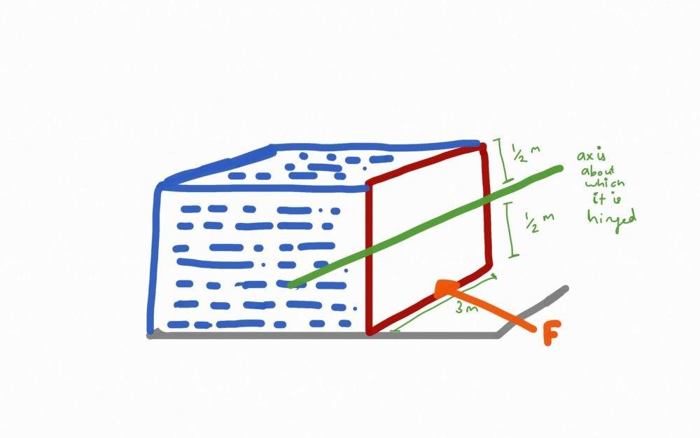

A rectangular gate, ##3m * 1m## , stands vertical with the water on one side of it, hinged at the middle. What is the force F required to be applied at the bottom to keep the gate in equilibrium?
##\int \!dτ = \int \!P.dA.x ##
Here, I am taking torque of the part above the axis##(τ_1)## ,which is clockwise, and the torque of the part below the axis ##(τ_2)##, which is anticlockwise, separately.
Now, let me consider a thin strip ##dx## at a height ##x## from the axis.
##τ_1 = \int_0^{\frac{1}{2}} \!ρg(x-\frac{1}{2})dA.3x## ##\tag{1}##
Considering, a thin strip ##dx## at a depth ##x## from the axis.
##τ_2 = \int_0^{-\frac{1}{2}} \!ρg(x+\frac{1}{2})dA.3x## ##\tag{2}##
Net torque due to water is given by,
##τ_{water} = τ_1 - τ_2 ## (considering the anticlockwise torque to be negative direction)
Then,
##τ_{water} = \frac{F}{2}##
But this does not yield the answer. It seems like taking ##0## to ##-\frac{1}{2}## as the limit is the reason why I am getting an incorrect answer. But why is it so? What is wrong when I take ##-\frac{1}{2}##? I took ##-##ve as the points below the axis are negative while the points above the axis are ##+##ve, considering the axis as the origin?
So what is the ##-{1\over 2} ## doing there ?
Likes Kaushik
So taking the axis as the origin, the part below it is negative while the part above it is ##+##ve. That was my intention. Hence, I took it as ##-##ve.
When I asked my friend about it, he asked me to take the magnitude. But I don't get the reason. Why shouldn't we take ##-\frac{1}{2}##?
If you use -1/2 your integrand is negative and the ##\tau_1## comes out negative. Would that mean it is pointing anticlockwise ?
Note that what you want to use is a difference in height to calculate the pressure. Pressure better be positive.
Likes Kaushik
Using -1/2, I am getting +ve τ. According to my convention +ve is for clockwise. But τ has to be anticlockwise for the lower part. Is this what you are saying?
So taking -1/2 has limit does not fit for pressure.
For e.g., for -1/2, when in pressure expression, then the value is ##ρg(0)## which is not the case. It should be ##ρg(2*0.5)##. So I should consider my limit as 1/2 and then later add a negative sign to it to show that it is anticlockwise. Is it?
Make a sketch (side view) and try to catch the whole thing in one integral from -1/2 to +1/2 . It's easy !
Likes Kaushik
Let me give it a try!
I got ##ρg/4## using the limit as -1/2 to 1/2.
You get the picture :smile:
