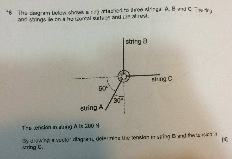

Problem related to vector diagram. Thanks.
In summary, the conversation discusses a physics problem involving a ring at rest and the forces acting on it. The participants focus on decomposing vector A into its components and understanding how these components must match up with other vectors in order to achieve equilibrium. The importance of equating vertical and horizontal components of force in finding the desired quantity is also highlighted in the conversation.
Help help
Refer to the diagram.
Stuck from the beginning.

Ya can't figure anything on this problem? Ya can't at least calculate the components of vector A?
The ring is at rest. What does this tell you about the sum of all of the forces acting on it?

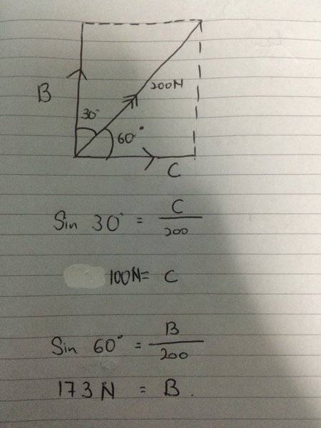

Attempted the question. Attached is my working. Does it make sense?

Well, now you're double posting blurry images, but it looks like you have decomposed vector A into its components.
NOTE: Your last image post came out sharp and clear. :smile:
Do you understand how the components of A must match up with vectors B and C to put the ring in equilibrium?

Actually, I may need help with the reasoning. Hehe
Next time you attempt these questions, remember when a body is at rest, you can equate vertical and horizontal components of force to work out tension or whatever quantity you are trying to find.
