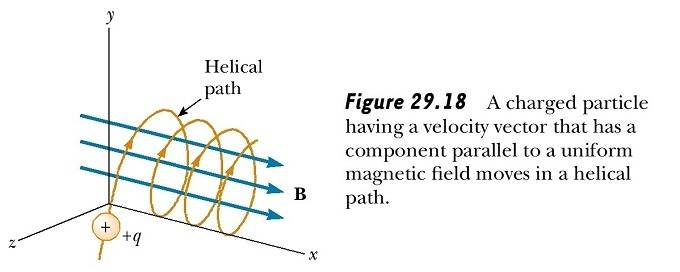

What I mean by that is that when there is no magnetic field, the particles just go straight through the plasma and hence, the probability of collision is small. But if you have a magnetic field, for example, A helical field, the particles spiral around the field the lines and drift along it.
Something like the image, but the magnetic field is helical too. So, the particles will have to spiral ALONG the direction of the field lines multiple times while simultaneously spiraling AROUND the field lines, before it can get to the other end. Sorry, I couldn't find a picture of a helical magnetic field. Anyway, so the probability of collision goes higher
Yeah, but the arc distance along the helical path is just vt, just like for a straight path.
You are confusing the collision frequency with the probability of undergoing a collision before a particle escapes confinement.
In a uniform plasma the collision frequency is path independent. If the collision frequency is [itex] 1 s^{-1}[/itex] then it is [itex] 1 s^{-1}[/itex] if the particle is gyrating in a circle and it is [itex] 1 s^{-1}[/itex] if the particle is moving in a straight line. The collision frequency is telling us that on average the particle will undergo 1 collision every second it stays in the plasma.
The probability of a particle undergoing a collision before escaping depends on the collision frequency and it's individual confinement time.
Adding a magnetic field will increase the particle's individual confinement time, but it does not change the collision frequency (assuming the density and temperature of the background plasma don't change).
In a magnetically confined plasma the collision frequency is low and the "fusion frequency" is even lower. To produce a net amount of energy we need to maximize the number of ions that fuse before they escape confinement. To do this we need long confinement times.
