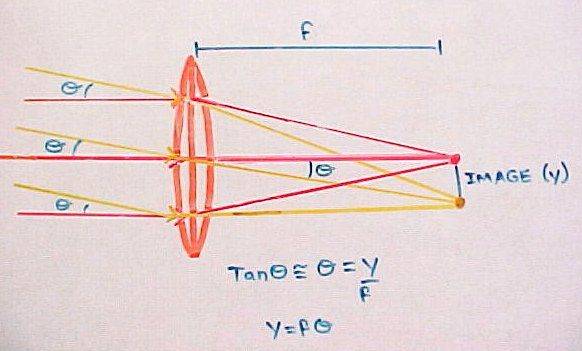

You have a slight misunderstanding of how magnification is calculated. From wiki: Optical magnification is the ratio between the apparent size of an object (or its size in an image) and its true size, and thus it is a dimensionless number.
Consider the angular distance (apparent size) between two objects in the image field, A and B, with no optical system present. If we insert an optical system, the magnification is determined by the angular distance between A and B at the focal plane. In the image below, red rays are from A and yellow rays are from B. As the lens power is increased, the focal length is reduced and rays from both A and B are brought to focus closer to the lens. This means that the distance between A and B at the focal plane is also reduced and so is magnification. So the longer the focal length of the lens, the larger its magnification in this sense.
Note that the above picture is for when the distance between each object and the objective lens is much larger than the focal length of the objective. In the image below we have a case where the distance between the object and the lens is smaller than the focal length. In such a case, the light will not form a real image, but a virtual one. When viewed by the eye, the apparent diameter of the object is larger than normal, as shown. Now, if we increase the power of the lens, the rays entering the eye would be converging, and we would have to decrease the power of the eye in order to still bring the rays to focus at the retina. This results in a drop in magnification since magnification in a two-element system is the focal length of the objective divided by the focal length of the 2nd element. But, in this simple case, we can simply move the lens closer to the object and leave the power of the eye unchanged. Since we are moving the lens and eye closer to the object, the apparent size of the object itself increases, which is then magnified by the optical system to form a larger image. In other words, the image gets larger because we can move closer to the object and still maintain focus.

Not necessarily true. Two different objectives can be of different thicknesses yet have the same magnification/focal length. For a simple thin lens, it's not the distance from the surface of the lens, but from the center of the lens that matters. For a thick lens, the focal length depends on multiple factors, some of which you can read about here: https://en.wikipedia.org/wiki/Focal_length#General_optical_systems
Note that it's much better to think about magnification in terms of focal length and angular distances rather than linear distance from a lens. This is especially true in multi-element and/or reflecting systems.

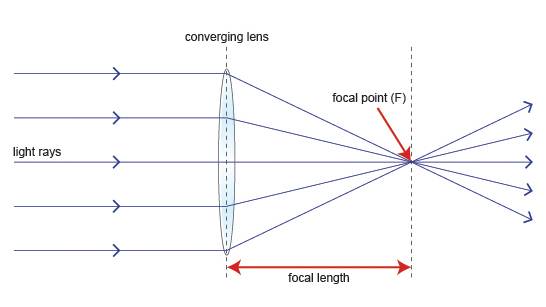

ViolentCorpse said:
2. An object placed at the focal length of a convex lens produces no image at all. Yet, there is no point in front of our eye where an object would suddenly disappear from our sight. What's going on?

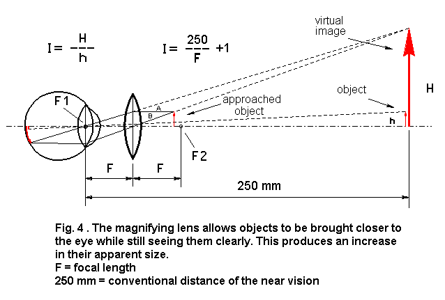

Sure there is. An object place around 15-25 mm from the eye will be at one focal length and the light will not form an image on the retina. When we say that an image isn't formed, we mean that the light leaving a lens/mirror is parallel to it itself instead of converging or diverging. However, you can still see an 'image' on your retina or on a camera lens, it's just extremely blurry.
I can't find a proper image, so we'll have to improvise. In the image below, imagine that the light is leaving an object at the focal point instead of converging on it. The light rays are refracted so that they emerge parallel to themselves. Now, imagine your retina is on the left. All of the light will fall on your retina within the diameter of that column of light, and none will be outside of it. Light emitted from a point just below the illustrated focal point will form its own column of parallel light which will mostly overlap the previous column except for a small sliver on the edge. So if you put your finger very close to your eye you will see a large, blurry blotch where most of the different columns of light from your finger are overlapping, but the edge of your finger will be an extended blur which you can see more distant objects through.
Likes ViolentCorpse
