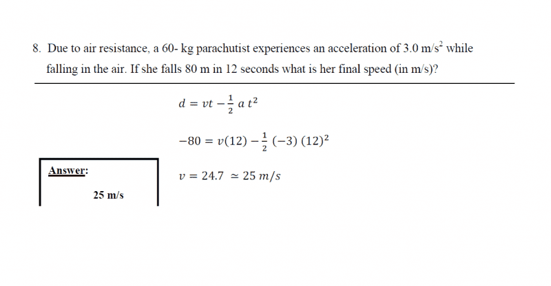

i have an exam and i was trying solving old exams and i came upon this problem
1. Homework Statement
Due to air resistance, a 60- kg parachutist experiences an acceleration of 3.0 m/s2 while
falling in the air. If she falls 80 m in 12 seconds what is her final speed (in m/s)?
i know its a constant acceleration problem so
vf=vi+at
D=vit+0.5at^2
vf^2=vi^2+2aD
D is Y2-Y1 =(-80-0)=-80
by using 2nd equation vi=24.7
and then using 1st equation vf should be -11.3
so final speed should be 11.3
but when i checked the answer i found it different
here is the answer that i found
d=vt-1/2at^2
-80=12v-1/2(-3)(12)^2
v=24.7=25 m/s
final answer is 25

this was a short problem from last year exam (it's the official answer according to physics department)
so i am not doing something wrong?
I can't see how they got this answer. For one thing, the solution to their equation is -24.7, not + 24.7. The equation itself doesn't make sense to me.
Here's how I would have done it (with downward velocities, displacements, and accelerations treated as positive):
[tex]80 = v_i(12)+\frac{3}{2}(12)^2[/tex]
v_i = -11.33 m/s
v_f = v_i + 3(12) = 24.7 m/s
Nathanael's method in post #2 is equally acceptable (maybe better), and gives the same answer.
Chet
