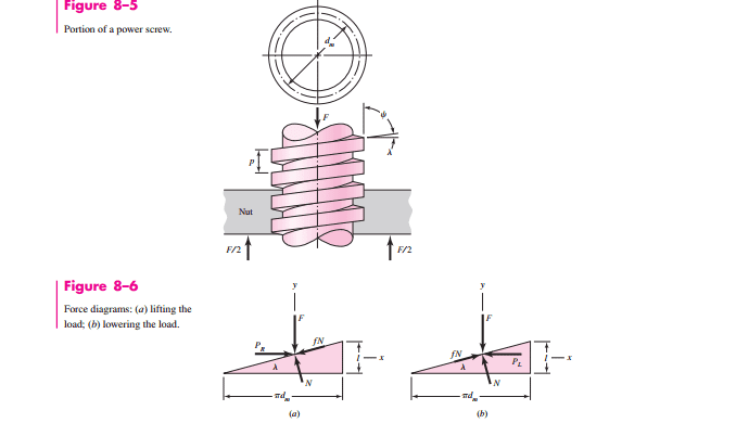

Greeting I have a problem understanding the forces applied to a threaded fastner
I really don't understand from where they got Pr or PL because for me the only applied force is F
thank you!
The confusion is probably because the diagram isn't for a threaded fastener - it's for a 'Power Screw.' The screw is raising (or lowering) a load - that's where the 'mystery' forces come from.
Likes Amaelle and berkeman
PR and PL correspond to the torque required to turn the screw (and lift or lower the load).
Likes Amaelle
thank you very much
Likes berkeman
thank you I got it now!
