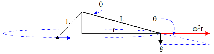

You've found a valid solution, well done. Since you've arrived at the answer I'm free to show you an alternative method.
If you make a drawing of the scenario and consider the accelerations experienced by the rock you'll see that the ratio of the gravitational acceleration to the centripetal acceleration will be equal to the tan of the angle. In this diagram the negative of the centripetal acceleration (red vector) is shown for clarity:
So that ##tan(θ) = \frac{g}{ω^2 r}##, where: ##r = L cos(θ)##. With a bit of rearranging and simplifying this becomes:
##ω = \sqrt{\frac{g}{L sin(θ)}}##
which should yield the same value for ω that you found.

Thank you! I'll remember that :)
