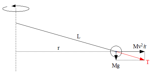

A ball whirling on the end of a string, length L
Maximum tension in string before it breaks: T sub break
Find an equation for the maximum speed of the ball , V sub max, in terms of the ball's mass, M, the breaking
tension T sub break, and the gravitational acceleration g
Ignore the angle theta the string makes with the horizontal plane
F= mass times acceleration
Acceleration = m x v squared / r (radius)
I used algebra and the Pythagorean theorem to get
v = the square root of L x ( T squared - M squared x G squared ) / M
but the correct answer is V = the square root of L x ( T squared - M squared x G squared) / M x T
I cannot figure out how the T sub break showed up in denominator

I formed a right triangle with the ball and string. The hypotenuse is T ( tension of string ) , the vertical leg of the right triangle is the weight of
the ball or mass times gravity. The horizontal leg of triangle is centripetal force F
So F2 = T2 - m2 x g2F2 =( mass X velocity2 / r )2 Equation 1
It is at this point that my math starts to break down
Ideally to get the posted answer I should get the equation
F = m x v2 / r = T2 - (m x g)2 substitute Length of string L for R
V2 = L ( T2 - (m x g )2 / M
V = square root of L ( T2 - M2 X G2 / M Equation 2
However I ignored the fact that F2 = ( m X v2 /r )2 in equation 1
Also the correct answer has M (mass) x T (tension of string at break) in the denominator equation 2
Correct answer is V = square root of L x ( T2 - M2 x G2) divided
by M x T
Possibly I should have broken the problem down to 2 equations
1) Equation for forces on ball Using F & T
2.) Equation for Distance Using length L and radius r
Then substitute a variable to get 1 equation
Okay. Note that L and R are not the same thing, so directly substituting one for the other is invalid.
Here's a diagram that depicts the situation:
The tension and centripetal force vectors have had their directions reversed so that they project past the end of the ball for convenience; It's the angles and magnitudes that are important to us. You should be able to use similar triangles to find a relationship between r and L that will allow you to replace r in your equations.

Thanks to gneill I think I figured the problem out Since we have similar triangles the sides are proportional ( see his diagram above)
T2 = (mg)2 + (mv2)2 / r2 Law of right triangles
T2 - m2 g2 = m2 v4 / r2 Eq 2
Similar triangles r/ mv2 /r =L /T this simplifies to R2 /mv2 = L/T
Substituting for r2 in eq 2 will give L ( T2 - m2 g2) / MT = v2
V = square root of L ( T2 - m2 g2 ) / M T
Voila
