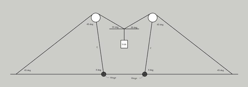

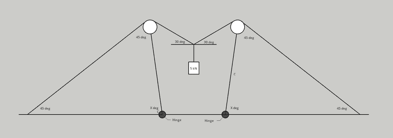

Calculate angle of mast and the compression force in the mast
In the question
Dear all,
I have the following problem:
I need to find the compression "C" in the mast and the angle that the masts makes with the horizontal (X degrees).
I know that the tension in the ropes "T" are of the same magnitude on both sides of the pulley, but I am struggling with finding C and X.
Could someone help please?

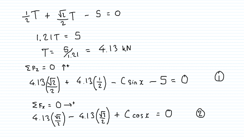

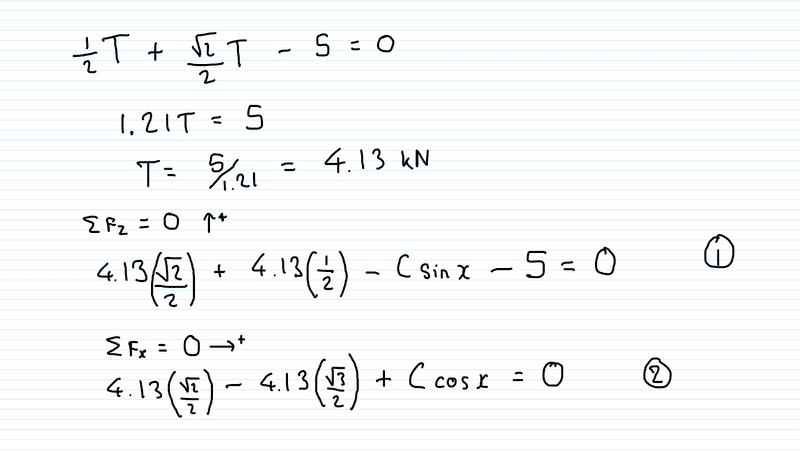

this is how I attempt the question:
When I do the final algebra, I am way off.
Tygra said:
Hi Lnewqban,

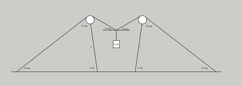

Please share a Free body diagram of the hanging weight, and a separate FBD of the mast.
Lnewqban said:
It seems that the original diagram shows the top 45° angle in error, as its reference should be a vertical line rather than C.
So are you saying they did this on purpose?

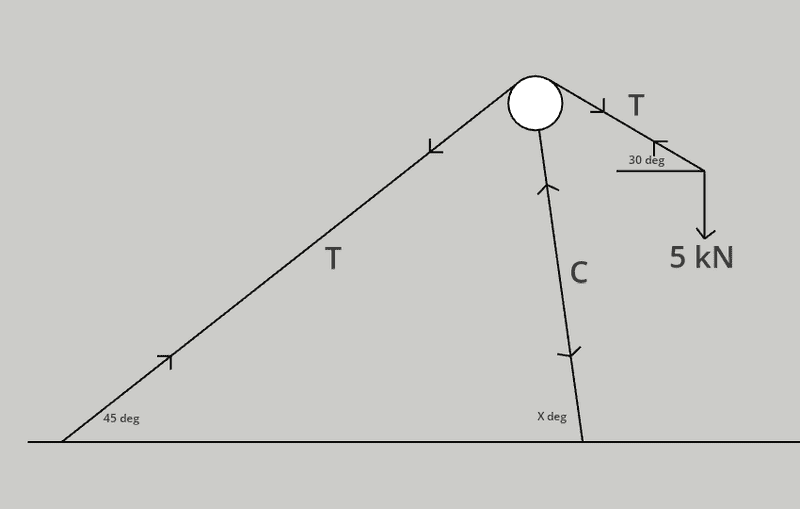

Here is my free body diagram:
Is this correct?
Tygra said:
So it must be a typo in the book? This problem is from a book.
Is this correct?
FBD of what? You isolate the hanging mass. Forces of weight ##W## and tension(s) ##T## act on it. You use it to find ##T## in terms of ##W##. Thats one FBD. The other is a Free body diagram of the member ##C##. You isolate the mast from the external surroundings. Tension forces, and reaction forces at the hinge should be shown. You use both component equations simultaneously to find the angle ##X##.
Thank you. I have it now. I think I was making it more complicated than what it was.
Is this correct?
Yes, it must be a typo.
Otherwise they would be giving away angle x as being 90° (45+45+90=180), which is an incorrect value.
In order to properly calculate T, you need to consider the “Y” formed by T, T and 5 kN.
In this case the “Y” is symmetrical and the value of T is the same on the left and the right sides, but it is not always that way.
Hope you have checked the example in the link previously posted.
