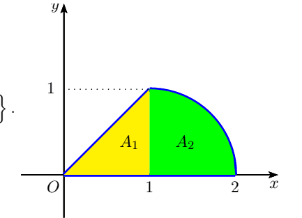

Compute the integral (3x dx dy), where the region of equation is : (x − 1)^2 + y^2 ≤ 1, 0 ≤ y ≤ x
0<=r<=2cos(θ),
I already have the solution in which the region of integration has been divided into two regions
but I was wondering if I can only use one region considering the polar coordinate system) the disk equation for me is r=2cos(θ) and the theta goes from 0 to (pi/4)
0<r<2cos(θ) and the 0 <θ<pi/4
the total integral becomes
is my approach is correct?
Thanks a lot in advance!

I don't see why it wouldn't work. See if you get the same answer with both approaches. If you do, that would confirm that your approach is correct, and would also be good practice for converting integrals from Cartesian (rectangular) form to polar form.

Thanks a lot for your prompt answer, the problem is that I couldn't find the same
Thanks a lot , i did it and it works!
etotheipi said:
You can do it even without a double integral. You just need to evaluate ##\frac{1}{2}\int (2\cos{\theta})^2 d\theta##$$A = \frac{1}{2} \int_0^{\frac{\pi}{4}} 4\cos^2{\theta} \, d\theta = 2\int_0^{\frac{\pi}{4}} \frac{1}{2} + \frac{1}{2}\cos{2\theta} \, d\theta = \left[ \theta +\frac{1}{2}\sin{2\theta} \right]_0^{\frac{\pi}{4}} = \frac{\pi}{4} + \frac{1}{2}$$
thanks a lot but i think you did a miscalculation the final answer is (3pi/4)+1
Likes etotheipi
Whoops... you're right! I thought you just wanted the area :doh:
