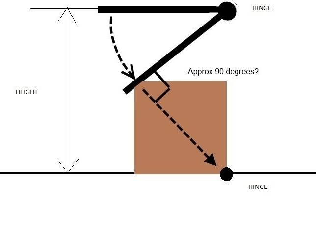

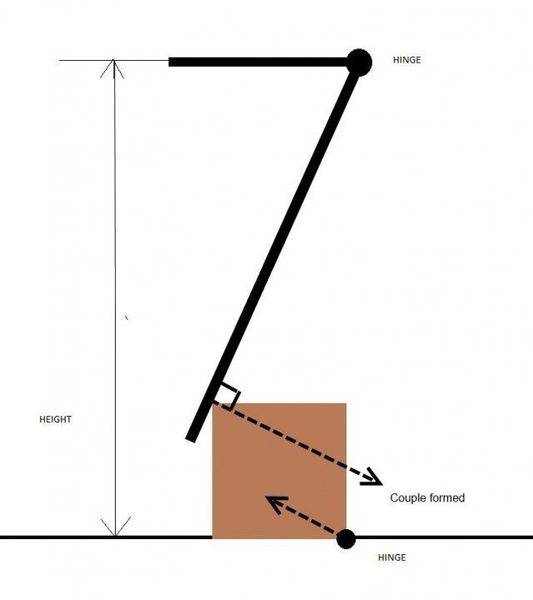

Hi guys i have a problem and I'm not able to solve it. I have a cube lying on the ground that is hinged on a side in contact with the floor. Right above the hinge there is a rod hinged (at the start time the rod is horizzontal) and it is long enough to touch the cube when it fall...how much the height must be in order to the rod to be able to rotate the cube after the collision?
I don't believe you have enough information to solve the problem.
One problem I see is that at impact the line of force could be towards the pivot point of the block. See diagram..
In that case there would be no torque acting on the block and it wouldn't rotate. The hinge point for the rod might have to be moved a lot higher and the rod made a lot longer to change this angle significantly.
One approach would be to calculate the Potential Energy (PE) of the rod in the up position. That would be turned into rotational KE as the rod falls. Then you would need to do some calculations to work out how much energy might be transferred to the block. I'm not quite sure how to tackle that because I think it would be difficult to apply conservation of angular momentum.
