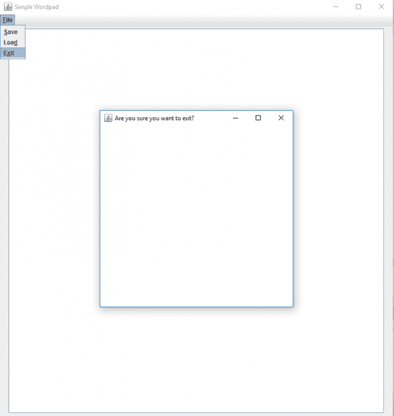

I am making a simple text editor program. You can load, save and exit, and other things.
I have the loading and saving working, but the exiting is giving me a peculiar problem. In my project, I have a gui class that extends JFrame, and I also have an ExitOption class that extnds JFrame. I am convinced that this is the root of my problem. When I create an instance of exitoption, It loads a box, with the title, but not my JLabel or my two buttons (ok and cancel). However, I made a new project with a class ExitOption, copied all of my ExitOption code from my other project to ExitOption project, and it works fine (the buttons don't do anything, actually, I am handling that in my gui class). Literally the same code, with the addition of a main method that has 2 lines
ExitOption eO = new ExitOption();
eO.setVisible(true);
Any idea what's up?

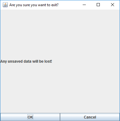

What I get when I run as part of my text project vs. standalone.
Also, I should mention, in Browse, I set the default folder to "./Files".
If you don't have that folder, I'm not sure what it will do, probably just default to the home container or whatever it's called. You can fix that by making it setCurrentDirectory(new File("."))
