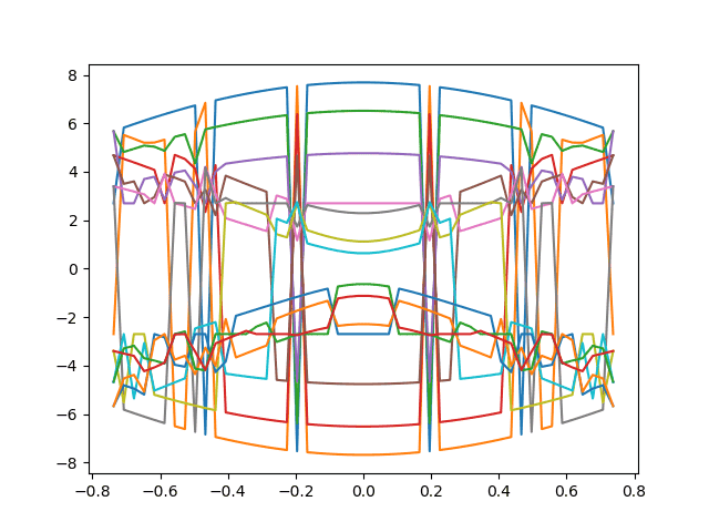

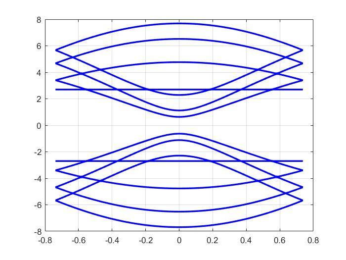

Hi, I have a Matlab code for calculating the band structure of graphene nanoribbon which is working fine, but I wanted to convert it to python and I've done it. I guess I made a mistake somewhere because the plot is totally wrong. Could someone check it for me, please?

Obviously not, they're not the same. I think the problem is in the calculating of H_tot. the final matrix is different from the same matrix in Matlab. but I don't know how to correct it.
The procedure is,
First, I must calculate total Hamiltonian, i.e., H_tot for each kx. Then find the eigenvalues of each matrix and put them in each column of a matrix named Ev. Afterward, plot each row in terms of kx values.
and since I am new in python I don't know where I made a mistake

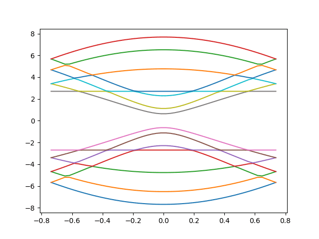

Actually, when I commet this line(np.sort...), the result is much more closer to the correct answer, but still incorrect.
Hi,
Is the H_tot line now outputting the same value in both Python and Matlab? If so, then what about the line that grabs the eigenvalues? I think isolating where the error lies in a sequential manner is probably the best thing to do.
In terms of using the sort function, just to confirm: do you want to sort by the real parts of the eigenvalues in ascending order?
Hi,
Thank you very very much for your help.
I add axis option to the sort command:
Ev=np.sort(Ev,axis=0)
and, the result is now correct.
