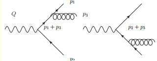

Hi, I'm trying to compute the cross section of a gluon emission from quarks in a electron-positron annihilation at first order (I attach the diagrams below).
Applying the Feynman rules the matrix element should be:
My problem is that I have no idea where this minus sign comes from. (I obtain a plus sign).
If anyone can help me I would be very grateful.
Thanks,
Pedro.
P.S. In the equation I posted, k1, k2 and k3 are the 4-momentum of the quark, antiquark and the gluon respectively and p1 and p2 of the electron and positron.
The momenta ##k_2## and ##k_3## are defined in the direction opposite to the fermion flow. In the other diagram ##k_1## and ##k_3## are in the same direction as the fermion flow.
