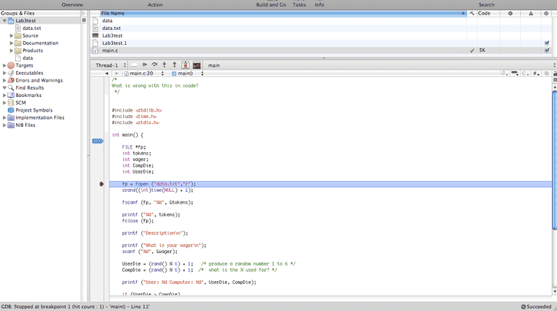

Hello all, I'm having a very frustrating time with this piece of code. For some reason, I can't seem to open the file I'm trying to read data in from. This piece of code works in everything I've tried, except xCode. This wouldn't bother me, but I really only use my laptop for coding, so I need it to work in xCode.
The debugger stops at the fopen command line, like it can't find the file.
If any of you can give me any help I would really appreciate it. I've included the original code and a screenshot of the XCode setup.
What is wrong with this in xcode?

It stopped because you set a breakpoint?
Press f5 (or whatever in xcode) or clear the breakpoint.

Check the return from fopen, input will be null if the open failed.
if ( input = fopen("data.txt","r") ) { fscanf(input...) }
My guess would be that xcode puts the build in a debug subdir and data.txt is in the current dir.
You sir, have made my week.
You were correct. The program puts the code in a debug subdir where the data file was not. If I move the data file to the subdir, all is fine.
Although that is somewhat inconvenient to do, it solves my problems for the near future.
There is probably an option in the debug setup somewhere to set the starting directory for the debug session.
